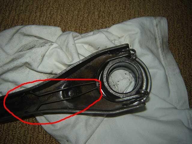

hey guys, sorry if i seem too careful/wutever with the questions but this is the second time i dropped the tranny this month and i want to get things done right. so any help would be appreciated. first, i heard that you have to put engine oil as lube on the pilot bearing, or can i just use regular grease that i use for input shaft and everything else? and second, what does this clip do and do i need it? it seems pretty easy to just fall out and bounce around in there.

There is a little gold ball looking thing on the tranny that you have to get the clip around.

That clip is the retainer clip for the clutch fork pivot ball.

Taken from another thread, but in this picture its broken. It should give you a good idea how it connects to the clip.
Originally Posted by AdamP View Post
projekt_s13 is offline   Reply With Quote

eh lol is that the pivot between the clip thats supposed to be bolted onto the tranny?
Yep, but it's obviously broken off and the aftermath is the ball still on the clip and what is now just a regular looking bolt still bolted to the tranny.

hm so i need the clip right? what purpose does it serve?

Wow.. I'm feelin' good right now so I'll be nice. You clip the clutch fork pivot ball onto the clutch fork retainer clip.

dont overgrease the Pilot. Throw out bearing needs no grease, just make sure it will fit into hole. You should not have to force the pilot bearing in with excessive force, I like to put mine in where it has free play. and yea, you needs to buy the ball for the pin. Looks like it broke off.
