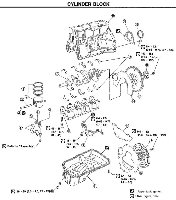

the FSm says 105 - 112 ft/lbs for the flywheel bolts.

Here, this is a scan right out the NISSAN FSM. Just like i said 105-112ft/lbs.
