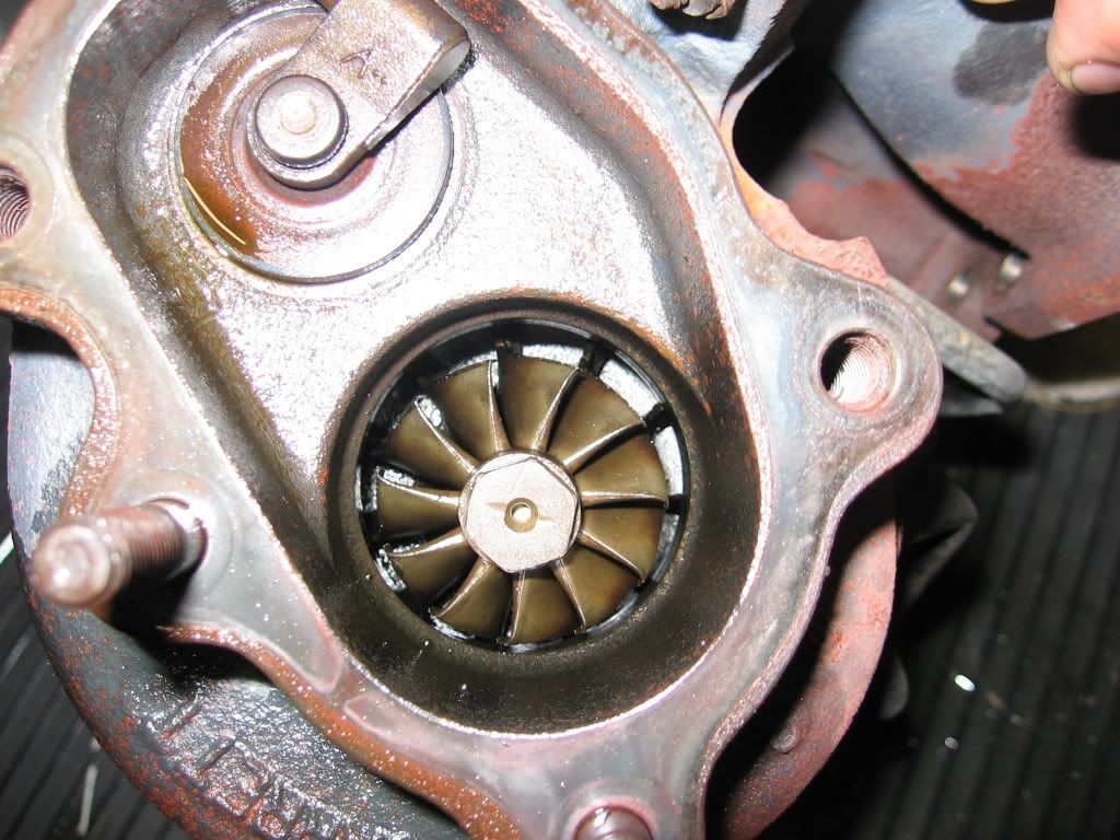

Blown Headgasket or Blown Turbo?
Alright, so here it goes.
It was Track day this past Saturday, stated to be apx 120degrees on track, 4th session of the day, i start loosing power on my 4th lap.
Symptoms:
Still could drive, but no heavy throttle response. NO turbo spool, NO sound from the blowoff valve whatsoever. Drove off track, came into the pits, and as soon as i left the track, white smoke from the exhaust. When i start it up, there is immediately white smoke and a strange metal/rattle/grind that tends to build up then go away, build up then go away as it idles. Just lovely.
I have not had much time to work on it, ive just started with pulling the intercooler piping and intake. The intercooler piping was soaked in oil as was the blowoff valve. Oil on both sides of the Intercooler. Id say apx a Quart worth in the intercooler system (heavy on the hot side).
I wanna say blown turbo just based on what ive seen so far. Others indicate possible headgasket due to white smoke, however im running Water Wetter/water mixture and not coolant. (Though i did not drain the block of coolant, just the remainder of the system and radiator). I just dunno.
Plans:
Pull the turbo, inspect all lines, shaft play, etc . . .
Remove intercooler and of course clean everything out.
Pull oil pan and check for metal and capaccino coolant mix (thanks Mr Samurai)
Basic setup info:
Stock turbo, Intake manifold, Injectors and MAF
Greddy intercooler & oil pan
(most)Coolant drained and Waterwetter/Water mixture
Suggestions or comments anyone?
**UPDATE**
Found the answer = Blown Turbo!
Talk about shaft play, side to side, up and down, left and right, oh . . . id say about 1/4"
Cleaned out the intercooler and piping, inspected the exhaust mani, coolant lines, oil lines, etc . . . no other issues found. Drained coolant and oil, pulled valve cover . . .no issues found.
Gonna now pull the intake mani and make sure its all cleaned out. There was oil surounding the TB so im sure the intake plenum is gonna need cleaning out.

Im convinced its the turbo.
My thoughts:
Metal friction noise = the shaft/spool grinding, considering it builds and goes away.
White smoke = coolant/water leaking and burning in the turbo, crack'd case most likely?
Excessive oil in Intercooler = gotta be turbo leak or crack once again. No catch can under a 30gal would have helped or even explained the Hot & Cold side oil saturation.
Im gonna pull it all one of these nights and try to reach a final verdict. Simple checking the dipstick, oil cap, and oil soaked intercooler didnt result in finding any chocolate milky oil. So i doubt its headgasket.

Thumbs down
That is A LOT of shaft movement. Take that into consideration on your diagnose.

Originally Posted by Mr. Samurai View Post
check if any chunks are missing on the fan or the shaft of the turbo, depending on the clearances the metal pieces can lodge into the valves leaving it floating and smacking into the piston, I've see this before, and can happen when you don't clean out the pipes well enough. its also going to be impossible to get all the oil out of the hot pipes and exhaust so expect the smoking for a while until its all burned off.. just make sure the smoke doesn't get dense. glad it wasn't the motor. everyone at the track went "awwwwww damn" when we saw you coming out the track smoking... Hope to see you in the next one...
LOL, i could see the looks of sadness as i pulled off. With my helmet on, you couldnt see or hear me going "fuck, fuck, fuck"
There doesnt seem to be any pieces or chips off the blades themselves. Ive completely drained the intercooler, piping & BOV but im sure there is still gonna be some in the IM thats gonna have to burn off.
My plan is to simply purchase another used T28 to get her up and running, and will most likely send this one off for a rebuild in the near future.
Im just relieved its not the motor.
