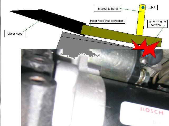

Do you have a S14? was the starter an after market one not an OEM replacement? (ie exactly the same)
http://www.zilvia.net/f/showthread.p...hlight=starter
just a thing to check.

i love you man!!!!! running
