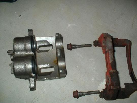

For reference, here is the stuff on FA that made me think that the bracket WOULD be included:
"No mounting brakets are required... they bolt right up."
Wrong answer. They do not mount right up. I learned this the hard way when I picked up calipers sans brackets and was stuck with nothing to attach them to.
Best bet is to buy new "Loaded" calipers which come with everything; I did that and couldn't be happier with my setup.
As a shameless plug, if anyone needs brackets I have a set now; found them after I bought loaded calipers.
This pic shows an UNLOADED caliper on the left and the bracket I'm referring to on the right:
So if anyone HAS received this bracket from Autozone, please let me know. Thank you.
