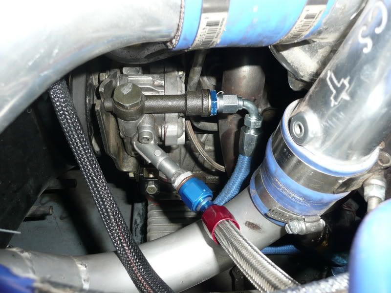

its real easy
here's a partial pic of my setup
i got it mostly thru sumiit but the PS line thru MA motorsports
here's the reservior i use .
http://www.allstarperformance.com/product.htm?prod=759
i use -8 on the return though!
ill get full pics later
if u want the part numbres and stuff let me know, i can get my invoice from summit for the PS rack
it was real easy
(ps reservour is mounted in stock spot area) ucan see the hsoes there
fittings i think i used
4 -6 90 degree
2 -8 45 degree
2 rack adapters (1 was w/ the ma motorsports setup)
the hp was 2 90 degree (ma motorsports included)
and pump fitting (ma motorsports included)
garage works welded the -8 on my return for ps pump.
Aaron
Pink GodziRa
