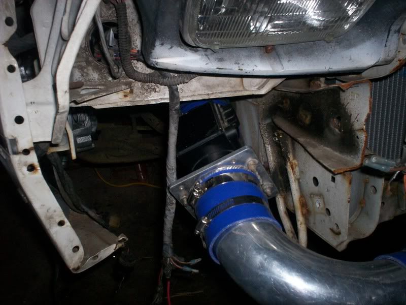

This is how i did mine. I still have to seal the maf with urethane than either zip or use hose clamps around the maf so it doesnt explode under boost. p.s im tuning with power fc/datalogit

thats where i had mine a few years ago when i ran a FMIC... when u log make sure u dont see any spikes.
