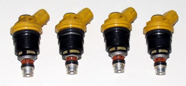

Yellow STI injectors DO work
Well, I put the yellow STI side feed injectors in my car, and it started right up and idled "okay" I could tell it was running a little rich, but it wasn't going to stall, I have yet to install the Z32 MAF or the ECU (both I have, doing that tomorrow, it got too dark). Just letting everyone know there is a nice low cost alternative out there. Hell, you can get them remained from autoparts giant for about $190 for a set of four.
Everything I have read tells me they are 550 high impedance. If anyone has any information that does not correspond to this please let me know. My ECU is chipped so I can tune it for the proper injector size.

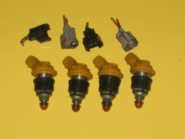

Here is a picture of the plugs and injectors for the Sti injectors and im almost positive they are high impendence just like our injectors.

Yeah,, that's pretty much them,, You can go to Autoparts Giant and pick up some remans for $165, or new Pythons for $190. Either way, its DIRT cheap for a nice injector upgrade. Look up part# 842-18132
