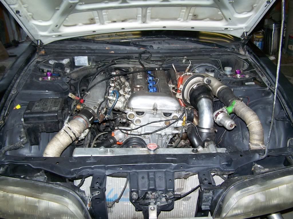

Those with Topmount Turbo's and ROM Tune with MAF, Please Help!
I have searched religioulsy locally, so I'm going to expand my search. I'm running a TS 3071R Topmounted with an Enthalpy Rom tune. So, basically I'm still running a MAF. I'm sick to death of Maf turbulence, the car idling like shit, and the car cutting off if I don't manually "catch" the revs. I know this is Mafs turbulence, but I can't lengthen my intake pipe anymore unless I have a custom one made (I can't find ANYBODY locally to do this and I've searched). So, can everybody show me the picks of YOUR Intake Pipe setup with a topmount and Mafs? Or, if somebody knows a shop or can build me a pipe that will fit in my bay with the appropriate length/bends I will gladly pay somebody. Here is a pic for reference followed with my current setup.
Now, my setup at the moment.

With "Blow Through" do you mean routing the breather from the Catch can into the intake pipe after the Maf? Will that eliminate my problems?
Also, the poster that put his pipe "down". Did that elimanate the turbulence??
I'm just sick of the horrible idle and such. But, is does run fantastic under full throttle.

I think Bardabe is right. I did have an extra bend in my intake pipe, but it was not a smooth transition to the turbo, and I was losing power, however, it would idle right *most* of the time and would not cut off between shifts, ect, ect.
I've checked TPS voltage, my base timing is 15* and my tune is Enthalpy, and I DOUBT his tune is off. I've had 4 tunes from him with all spot on AFR and such. I have not checked the IACV, but it does not seem like a problem related to that.
So, from what I'm reading, a blow through setup would be the easiest way to rid all of these problems? Or, get a custom intake Pipe?

actually i really think its the MAF problem my buddy had the same problem. (Vinhisbored) we extended his intake pipe to 18" and walah! everything was A Ok.
Do you have a picture of this setup? I've looked the engine bay over, I just don't see anywhere to extend this to unless I have a custom Intake Pipe made with several bends. I've already purchased the Aluminum pipe, I just cant find ANYBODY willing to custom make one for me.

Anybody else have pictures of their setup?

its downstairs where u cant see it unless ur out front layin on the ground.
the extra width opening is for the ported shroud - the compressor wheels inlet is still little...
not driven in or around water... - just so u guys know.

Smelly240, thanks for the picture. I'm going to try and figure out something soon. Is there any way you can snap a picture of the actual Mafs and Filter location?? Thanks!

Good point on the 4" opening- I wonder if that significantly affects turbulence within the MAF when using a sharp 3"-4" transition coupler. From what I've read about the ported shroud housings, I'm not even so sure I'd want one, but that's besides the point if you already have it on there. I'd say that somehow relocating the filter and MAF to inside your front fenderwell is the way to go. Also try to keep the BOV recirc hose and/or catch can vacuum source far from the MAF is possible.
