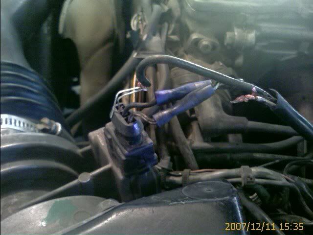

Hey I have another Question, I have a Senor in my Air box not connected to anything and I can't seem to find where it connects too ... I am posting a pic to see if anyone can help me figure this out
.... Also I bought this car like this mine you... Does anyone know where i can get one of these plugs? I went to the local junkyard and not a one 240sx... you gotta love the creativity of some people to do what needs to be done... LMAO thanks
