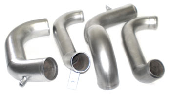

But on a serious note, I bought this kit. http://store.racing-solutions.org/2suexbukit.html

Yup, I pm'd him the url to that site. That's where I got my piping as well---cheap and effective.

http://jgstools.com/turbo/index2.html
$299.99 USD
