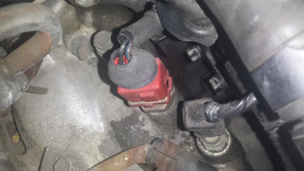

ive attached a picture of something that i wiggled the other day trying to figure out what was wrong and when i wiggled this little gizmo i noticed my idle started moving up and down. is this thing the knock sensor ?

That's the coolant temp sensor. The sohc ka doesn't have a knock sensor.
KA injectors frequently die -- if you are sure you have spark, I'd just check the injectors.

That red plug 'gizmo' is the coolant temperature sensor.
Edit: I also had a miss similar to this. As said above ^ could be the injector. It doesn't necessarily mean that the injector is 'dead' but possibly wiring issues to the injector. Mine was the injector on cylinder #3 and when I would wiggle the plug it would cut in and out. ended up re-pinning the plug and all has been well since.
