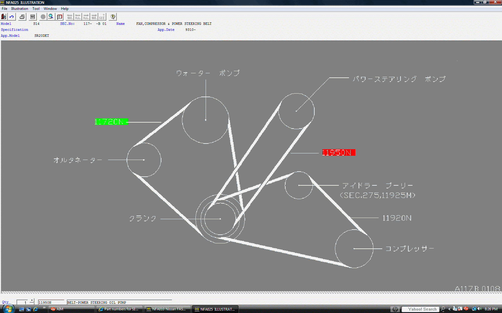

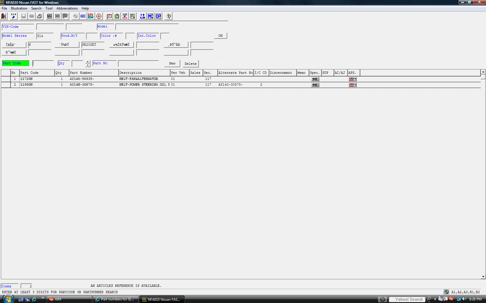

Old 01-08-2008, 09:30 PM   #11
UNISA JECS
UNISA JECS's Avatar
Location: Socal Fontana
Posts: 2,380
Trader Rating: (40)
Feedback Score: 40 reviews
