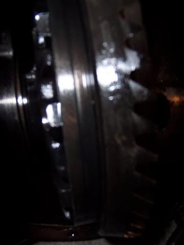

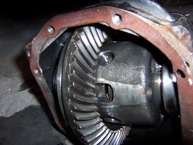

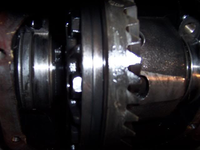

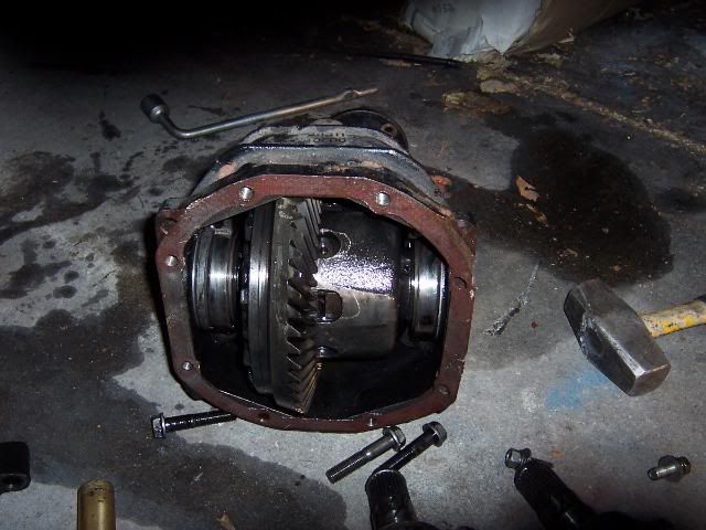

lsd identify plese.
ok i have a problem.
i think this is a nismo lsd. lookz similar from the one on courtesy.
the problem is its reallie hard to turn. on the ring gear (bigger) it says 43:12?
which is the higher one i believe.
the thing is its hard to turn.
history of it been sitting for awhile. and oil in it is reallie old. and when i cracked it open it dint even have to drain oil out.
my 2nd problem i took out the output shafts. and i forgot which side goes in which side and i dont know the tq specs of the brackets.
please help.

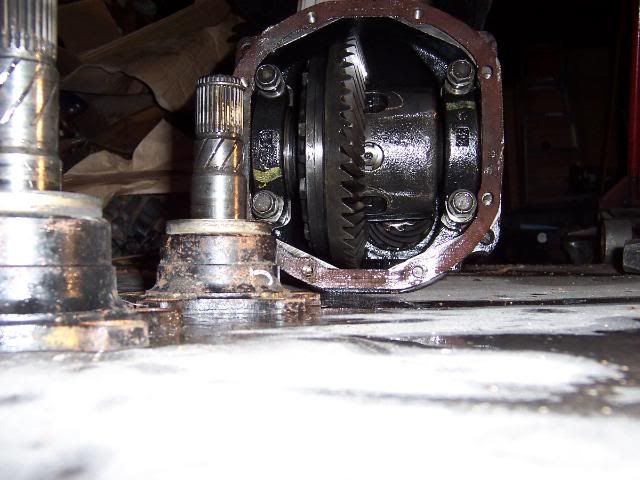

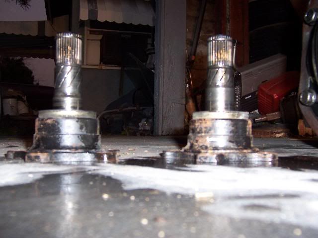

ok i found the write up with specs. but i still dotn know which output shaft goes where.
can i just use my 6 bolt shafts? the one thats on it rite now is 5 bolt.
and the casing is the vlsd from a 180sx.

Jung918 is close to perfectionJung918 is close to perfectionJung918 is close to perfectionJung918 is close to perfectionJung918 is close to perfectionJung918 is close to perfectionJung918 is close to perfectionJung918 is close to perfectionJung918 is close to perfectionJung918 is close to perfectionJung918 is close to perfection
shorter output goes on the left side (driver side)
