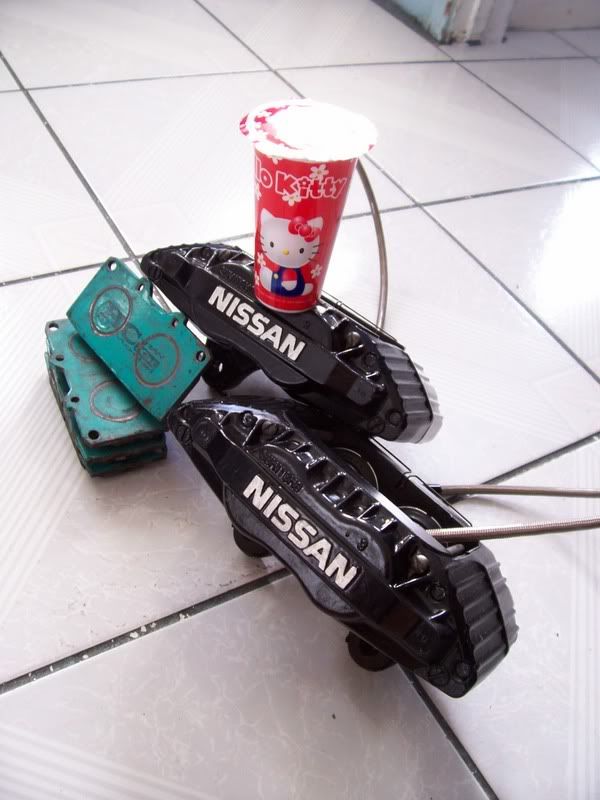

Z32 Calipers Or Q45 Calipers
I know this has probably been discussed forever and a day but I wanted to know opinions on the price and the difference. Well my local parts store is cutting me a deal on calipers and rotors for both options. The Z32's with stock front rotors he's selling to me for $325.00 thats already including tax and I can still turn in cores worth $100. So if I turned in cores I'm looking at roughly $225 for everything. He said he couldn't guarantee if they would be aluminum or not but for me personally it wouldn't matter too much either way. The Q45 are the calipers with mounting brackets and the front rotors as well. For those he said $260.00 including tax also can turn in cores worth $100. That would be roughly $125 after cores turned in. I've searched and this price is a lot lower than most places offer by alot. The prices are a lot closer to what a used set goes for. Both sound like great deals to me just the choices. With the Q45 I wouldn't have to buy wheels to put them on. Opinions please. Also if anybody else were interested he said he would cut them the same deal.

Dousan is right... people get Z's cause they look better. not everybody but the majority.
i have sum 30mm with ss lines sittin in my garage and havent put them on because i want better wheels and dont know if in the end they will clear so i've been contemplating on selling them and just gettin Q45's
