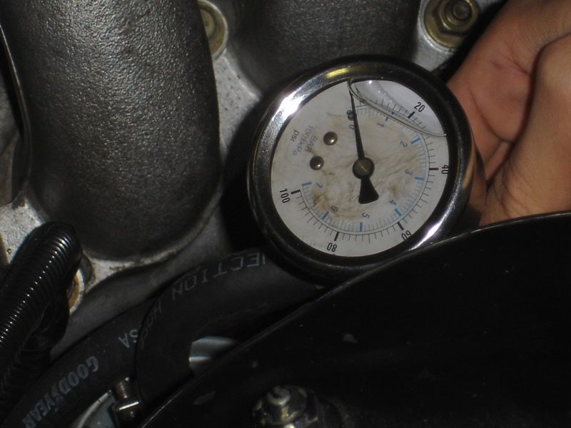

Alright, so I didn't get to turn on the car today but I turned the key all the way so that the fuel pump came on and I took a pic of the pressure in my fuel. I dunno if this helps but tomorrow I'll take another one with the car on.

@43psi w/o vacuum is right for most cars, so it looks like your fuel pressure is good. check your #2 injector wiring, you might have a short, causing the injector to stay open and flood the cylinder. even if you're not getting spark in that cylinder, you shouldn't be flooding it with the stock injectors, it seems more like it's stuck open if it's flooding.

So today I cranked the motor a few times without the fuel pump on to try and get out the excess fuel. After that I blew some air into the cyclinder to dry it up.
I also changed my vacuum lines with brand new ones but now the car wont even idle anymore!
I noticed that my fuel pressure when I pumped the throttle from the engine bay, was going from 39-40 psi. I dunno if thats normal?
