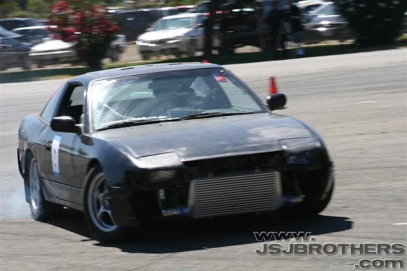

my sig is my budget track car. Had an SR but i got for super cheap cuz it came out of my friends crashed car.
If you dont really drift then I guess suspension, brakes and some good tires would be the way to go
