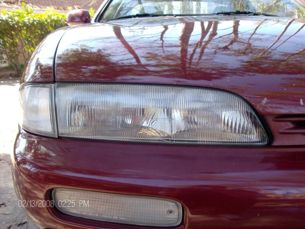

WOW! What a difference. 2000 grit + soapy water + 20 minutes = No more surface imperfections. It leaves the headlight looking mighty hazy, but paves the way for further action. 30 minutes with polishing compound, and the headlight is looking damn good. Close to new, in fact. Then top it off with clearcoat made for wheels, and it looks exactly like new once you let it cure and then hit it lightly with polishing compound and then a coat of wax.
Pics when I can find my camera cord.

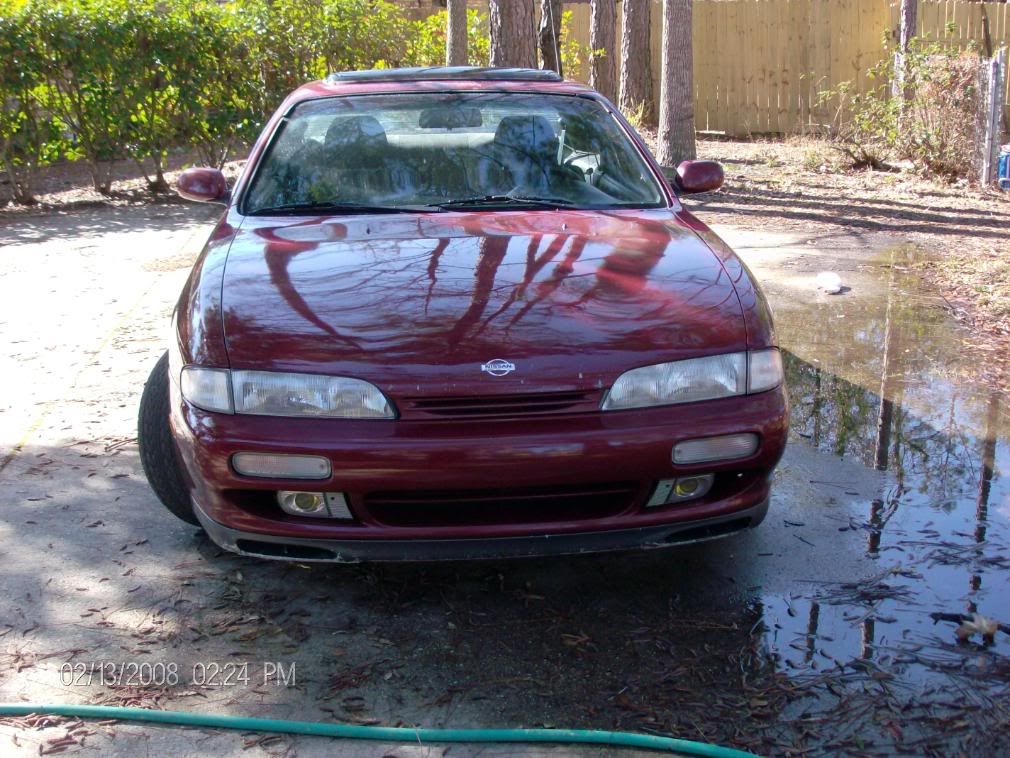

I don't have any 'before' pics, because the only pics I have are when I first got the car, and it wasn't that bad then... but just imagine your 'typical' cloudiness. Nothing life-threatening, but ugly nonetheless.
Whadayathink?

looks good. but you have to keep up with it, or else it yellows over again. ask me how i know... >.>
Even after clearcoating it?

nice n' clean good job and do let us know about how long it lasts

Def let us know how long it lasts...if i have to keep sanding my headlights there will be nothing left!!!! haha

i do/did the same thing. bit when i do it i just use mothers mag polish and a clean rag. scrub the headlight wiht the mag polish on it and once it is clear enough for you put wax on it. any kind of wax works. i done this like 3 or 4 moths ago and mine havent got yellow yet. the car has seen snow rain and sun.
