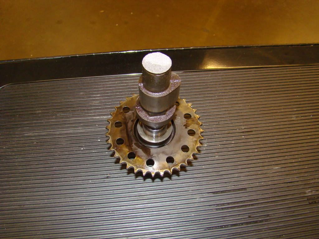

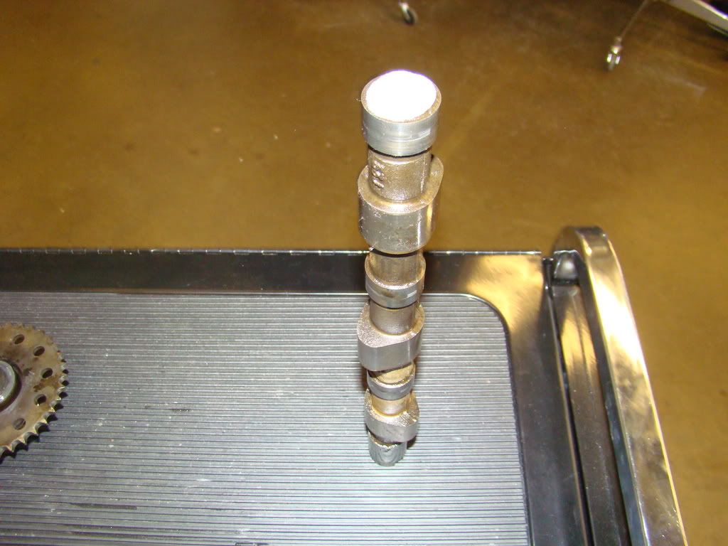

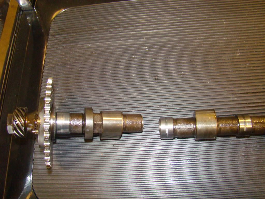

alright so last week i found out that i had my retop timing set 180 degrees off ...so i go to fix my timing yesterday and as i pull the cam bearings off i realize that my cam is in two pieces...:hammer:. Anywho i buy a cam from VUTONY (thanx for saving my ass) and i set the timing to what it should be and everthing is cherry right? of course not...i crank and i get nothing...im thinking im not getting fuel, anywho after i run out of things to check, my friend and i decide to do a leakdown test and i have 100% leakage on all four cylinders. i can hear air coming from the exhaust but not from the head or the throttle body, this means its the exhaust valves right??? and not the piston rings right??? eh just thought id share my stupid mistakes....sorry if this doesnt go in tech...if you have any ideas of other things it could be besides the valves please chime in...

Did you crank the engine with the broken cam? My guess is bent valves if you did especially since that was the exhaust cam and the sound is coming from the exhaust.

It has been explained. Didn't follow directions, the CAM got pwned and the valve stuck in the open position. You cranked it, the piston slapped the valve and bent the valve. The valve due to deformaty will not recede back into the head fully hence compressure issues. Also you never know i you have cracked the piston as well since you slapped it that hard or at least nicked the crap out of the surface. Standard engine issues.....
Hench also friction on valve seals, the seals are gone now probably. Timing was off and you might have bent all 4 valves. Doesn't know, but what you did is basically what causes engines to blow. Not just a booboo, its full engine pwnage. Sorry full tear down on your way....

yeah turns out none of the valves were bent...and the cam was snapped due to improper torque patterns...the pistons did not have a scratch on them...but i found a little piece of the cam embedded in the cam journal...i fail haha but hey its a learning process right...? it comes with doing your own shit, i will say this though i wouldnt trade this experience for anything, cuz now i know to quadruple check everything lol, yeah thanx for helpin out and not flaming me guys...
