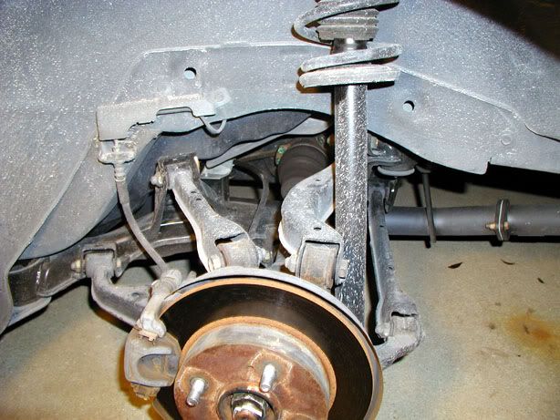

Where is the cable under the car? Need a visual aid here, the FSM isn't helping. And do I just take my wheels off and see if rotates?

Look between the upper arms. The line on the left of the axle.

Thanks for the pic
