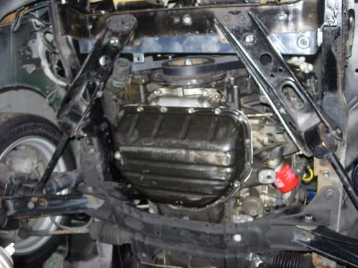

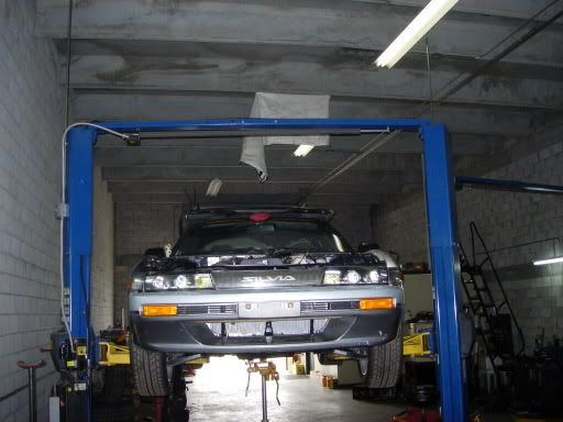

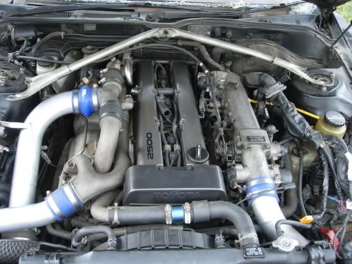

i know a lot of people may not like it...but here is my project.....plase feel free to make intellegent comments

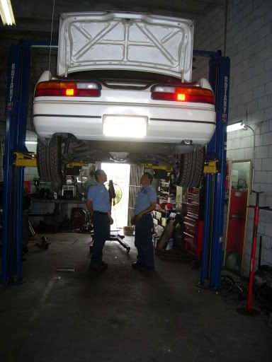

well my project is comming along nice...i was at the shop all day yesterday working on installing the motor and tranny....
im gonna post some pics so far....
on the way to the shop

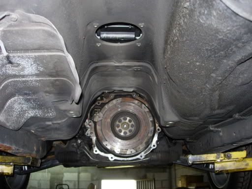

clip...jzx81 5spd
engine in the clip

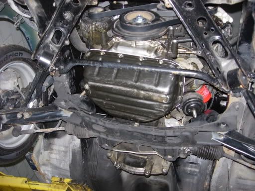

analyzing the situation
dropping it in

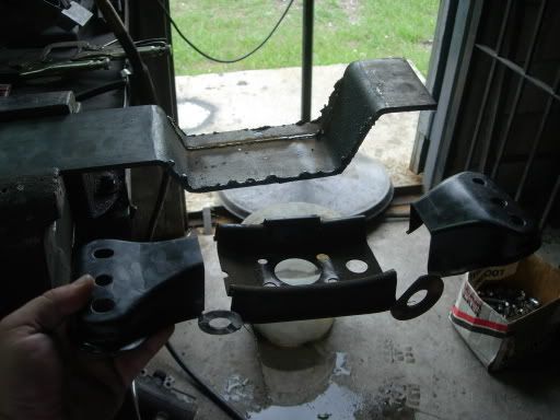

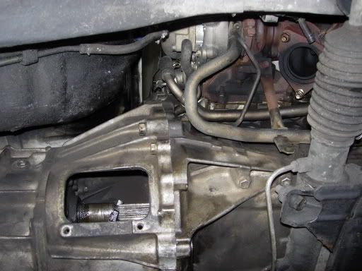

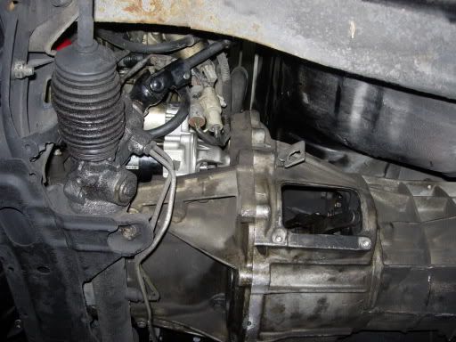

tranny bracket being made

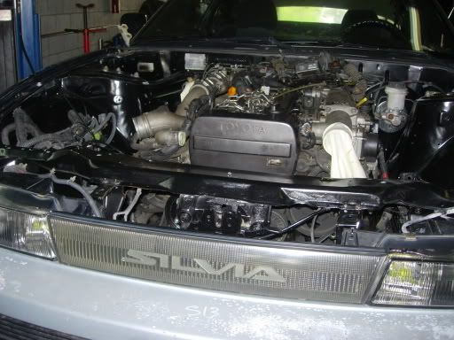

the set up is going well..the shifter is a little forward but we will cut and bend and correct it....motor mounts will be worked on in the next comming days....
since im not running a.c im going to move the engine a little forward which gives me alot more room around the engine and room to work....i will be putting my electric fans in front of the koyo radiator for extra clearance

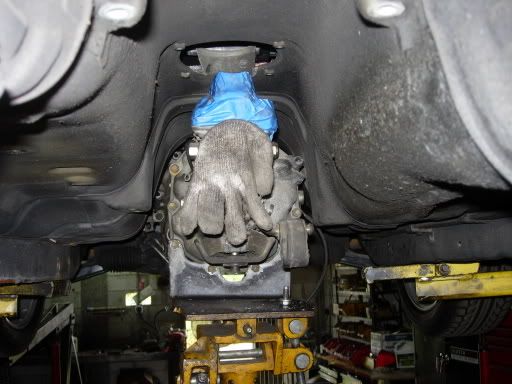

the tansmission tunnel fits the tranny just fine...a custom mount will connect to a stock s13 vlsd rear end...
comments and such are welcomed...i have worked slowly on this project for over 2 years now...so its very excting to see it where it is today...hopefully running by the end of the month..
Jeff
89 silvia/1JZGTE
6765 dbb E85 527rwhp

That is some nice work you have going on there. Do you mind telling me why you decided to do this swap?

i decided on the motor because ive allways had turbo 2jz engines and love the durability and power potential of the supra motors...love 6cyl torque and exahust note.......so i wanted a 2jz at 1st....but i wanted a manual car and wanted to keep prices down..this is just a fun project for street driving.....occasional road course scca fun and occasional drag fun...i want it to be an all around car..and felt the 1jz would fit my price and power wants just fine.....i want 400-500 rwhp on boost with a mid size single turbo and nitrous...like a 100 shot for fun times drag racing......
so a 1jz for 2800 complete...full clip vs a 5000-6500 2jz 6spd clip seemed more reasonable...and i can mod this motor to my power goals with the exta $$$
as i complete the mounting and get it running ill update with pics

this is going to be a one time fabrication....plus im putting my engin very forward...most people will want a/c and have theres further back....
but it is a very do able swap so far...just need a half way decent fabricator shop and you wil be able to pull it off...
one thing though.you need a front sump oil pan for the 1jz....

^most people will want the motor futher back to offset the weight of the motor. Fuck AC! lol Good shit man, thats going to be cool once its done.

Nice work! Looks like your trannymay rubb the right side of the tranny tunnel. Hammer time?

for the tranny tunnel that was early in the day before final mark up...final position gives me plenty of room all around....
as for weight balance...there really isnt a major significant differance between the 2.4 kat and 1jz...1jz is heavier but minimaly and with no a/c up font...battery in back....it should be a wash as far as weight balance...i will scale the car later both for weight and corner balance.....also solid engine mounts will keep everything from even comming close to rotating and rubbing....
and as far as moving forward..im talking an inch or 2 forward...thats it.....

make custom mounts!

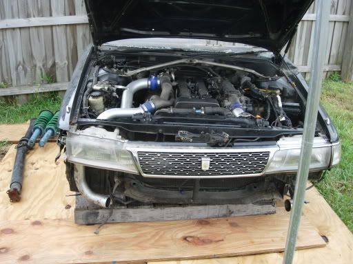

well the swap is going well..engine, tranny and drive shaft are all mounted up..
ran new fuel lines and clutch line
just mounting up the radiator, fans,intercooler and wiring left...
hoping to have it running by the end of the month

future plans are a small to mid size single turbo and alot of suspension work.....i love all kinds of racing..so i want a set up i could take to the drag strip and hit 10s in...but i also wanna do some road racing...down here in miami theres some groups that run down at homestead miami speedway...and id really like to do that too....im not really into drifting..but i do enjoy sliding out the rear end here and there....we will see how it goes.....im not closed minded to anything with this car...
this car is just build for fun ...as a weekend toy.....my daily driver is a turbo lexus......
so i wanna set it up as a great performing all around car.....
my goal is 2500lb car with 500-600 reliable rwhp
