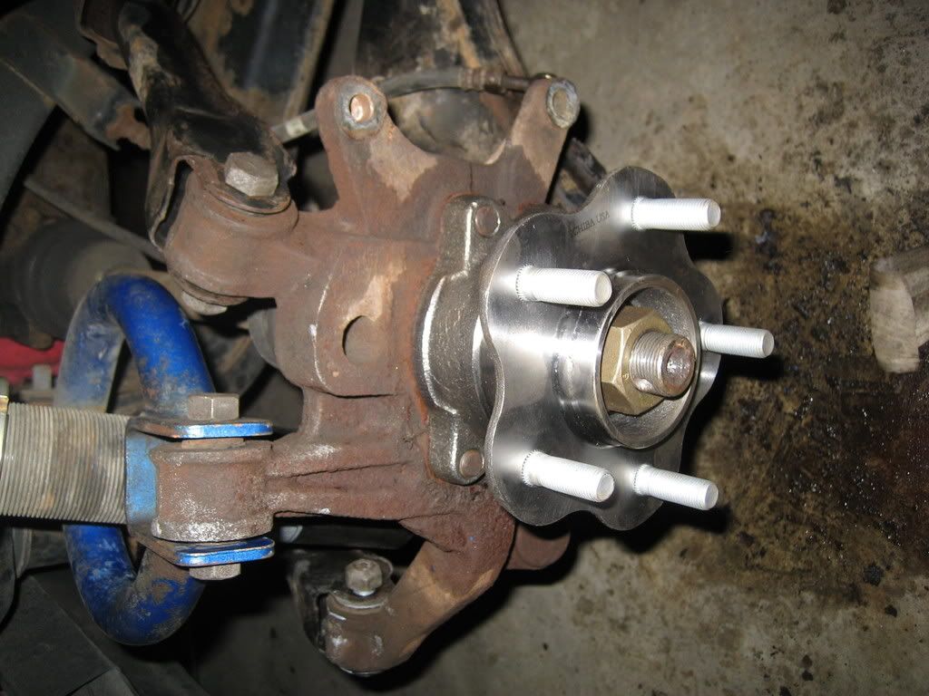

loosen all the bolts.. so your suspension,( coils, ruca, toe and caster)once they are all loosened, then take all the bolts out.
also take off the brake caliper
get an impact or a lot of muscle and zip off the 36mm hub bolt.
pull the entire knuckle down. and you take off those bolts to the hub..i BELIEVE they are a 17mm. to get to them you will have to turn the axle a 1/4th turn each time..its not hard. but since that hub is pressed in there you will have to pop it out..i used a hammer..make sure you put somthign on the other side of the hub so it sits still or it will flop around when you hit it. take a screwdriver and a hammer..and go to down..on the hard usually shinny metal.. i mean..do you really need your old hubs?.lol
once they are popped out, you have to put on the new hub. slide it on. and put bearing grease in it. and get it in there well packed..
impact the hub bearing to spec..
i believe its
120-180foot pounds of torque.
but if you impact it..just impact it till it cant move. it should be enough.after that..bolt all the suspension parts back on. put on the rotors and calipers...
then its done.
oh i used a lot of pb blaster the day before..i soaked everything..it made it a lot easier.
sorry i thought i had a lot more pictures..but this was the only one that could help you
HS13KLS is offline   Reply With Quote
