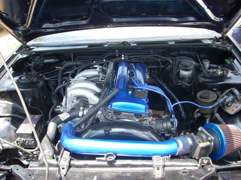

hey guys
im waiting for one of my friends friends to come and do my timing perfect so if its not a timing issue i can eleminate that problem..
heres a pic of the engine bay. idk why you want to see it pero ok.

not that it matters, but your o2 sensor isnt hooked up <3

Ok well that bay looks nice, ditto on the o2. But I do see the IACV connected so it can't be that. But I do how ever see that you don't have your stock headers on? no back pressure. hence I believe it would choke.

lmao! na when i took this pic the headers werent on, there on when i work on the car..
and yes i do connect the o2 when i start the car but thats not the problem..

I know you said that wasn't an up to date pic, but it looks to me that one of the vacuum lines right next to the upper rad hose on the intake isn't connected, the blue is visible.

i do connect it when i work on it as well, but that doesnt even have nothing to do.
from thousands of members here no one can give me a better advise or idea???
i got a multi meter today, ima check the voltage coming from the pump at all times to see whats up with that.
idk, feel free to say something guys.
thanks

Check your fuel pressure regulator...if car is running fine while you have the return blocked off your regulator may be torn and bleeding off fuel pressure. That and i can't see your pic im at work but make sure your fuel lines aren't connected backwards.
