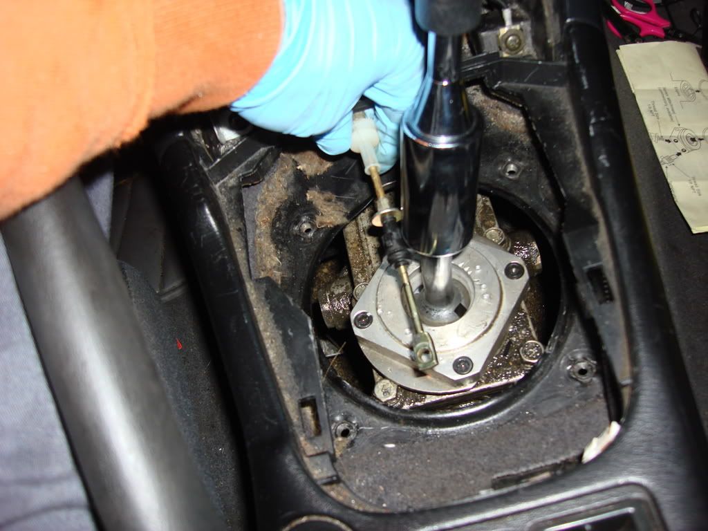

i havn't checked the grounds yet. but i took pics before u guys told me to do that and just decided to upload them now.
where does this go...?
and does anyone else have any other suggestions besides checking the grounds and the battery connections?

just wondering if anyone knows where that thing goes in the first pic...?

got any clue where that "switch" goes in the pic of the shifter?
it like locks the key in but i don't know where it connects to so that it engages and stuff on it's own.

that is the automatic shifter key release. it basically can be pushed forward and forgotten. (it keeps the key in the ignition when an automatic is anywhere except park, but you dont have auto do you?) so simply push it up, to emulate park, and forget it.

Take the 4 screws out from below the steering colum and pop the top off and the key cover off. You should see were the cable goes into the ignition switch. pull the retaining clip and then you can remove the cable and throw it in the trash. No more stuck key.
Does the car crank?
Do you hear fuel pump priming for 1 sec in the on position?
Check engine light come on when put in in the on position?
alright thanks!
gona take it totally out actually like s14db said.
but the info was great. didn't kno if it had to stay in.
