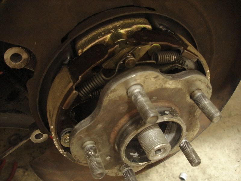

I just installed the Z32 uprights, along with the brakes on my S13 hatch and when I went to tighten down the axel nut, I realized I could not spin the hub or axel at all, it was really hard. When I loosened the nut, I was able too spin it. Any suggestion?
I've noticed from a few write ups also that people install the ebrake assembly and uprights THEN put the hub on, after the other stuff is bolted onto the chassis. The way I did it was I put the hub,ebrake assembly, and uprights all at one time. I dunno if that might be the issue?
Here are some pics of my setup.
Here's what I mean when I say people install the ebrake assembly then the hub. What I don't get is how do they install the Z32 hub because mine has the tabs as shown in the second picture which I got from here.

People with tabed hubs cannot install the ebrake assemblys togther like shown in the pics because uts impossible.
People with non-tabed hub can.
The way it shoudl be done is completely diassembly the ebrake assembly install the backing plate, install the hub, then install the shoes.

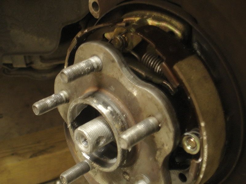

Thats the way I did it, I put the hubs on the backing plate, than reassembled the shoes and the equipment for the ebrake shoes. So with the hub, backing plate, and ebrake hardware, I mounted it all in. I believe my tab, from the hub touches the backing plate, then I put the pin thing where the shoes hang onto. I tightened up the 4 bolts that hold the hub in the back, then the big 27mm iirc bolt on the back. From there I slid it into my axels.
I think I was going to cut off the tabs but was worried about the bolt shown in this pic, not being able to be threaded all the way.

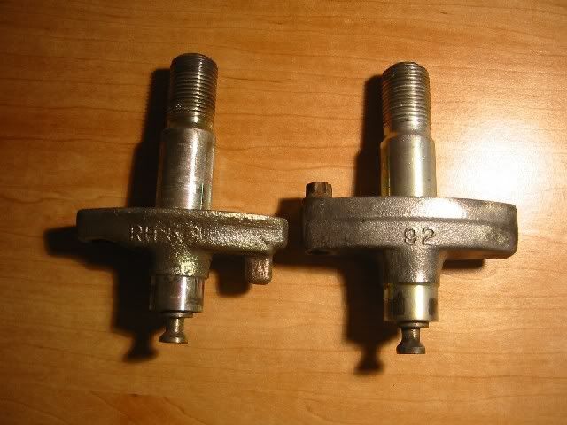

Ok this is what you do:
TABED HUB'S CAN ONLY USE THE ANCHOR BLOCK BOLT ON THE LEFT PERIOD!
NON-TABED HUBS CAN USE THE ANCHOR BLOCK BOLT ON THE LEFT WITH TWO AXLE WASHERS OR THEY CAN USE THE ANCHOR BLOCK BOLT ON THE RIGHT BY REMOVING THE HEX BOLT AND DISCARDING IT.
THERE YOU GO, ITS VERY SIMPLE
THE USE OF 2 AXLE WASHERS ON LEFT ANCHOR BLOCK PIN MAKES UP FOR THE MISSING TAB ON THE HUB.

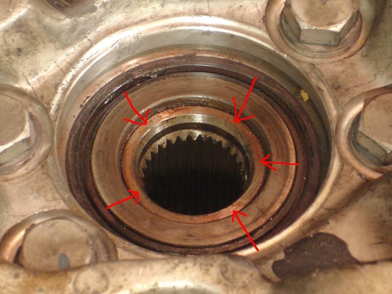

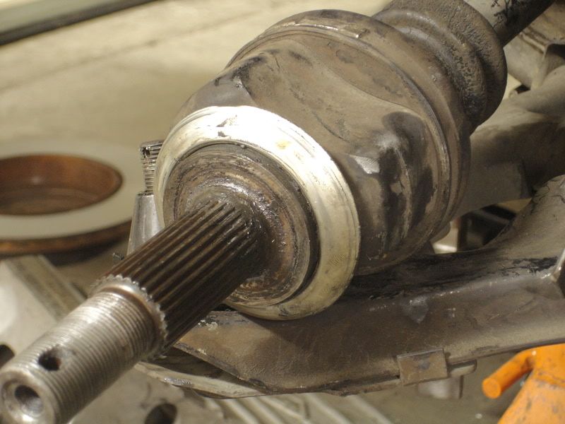

Are you by any chance using J30 5 bolt axles? If you are you have to knock of the metal seal on the axle itself.
Circled in red on J30 axles need to be removed if you use them:

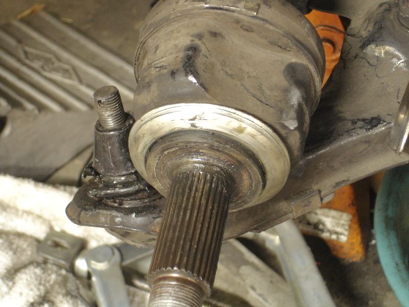

Here's the axel on mine right now. I don't think the previous owner changed the axels. But here's a pic, if you need a closer shot just let me know. I want to get this problem fixed fast.
Refer to my last post, remove those axle seals, it looks like one of them have been distorted from teh look of it, like like and interferance.

Alright I'll go ahead and try knocking it out to see what happens, I'm just affraid of damaging something.

They pry off easily with just a screwdriver and hammer. You won't hurt a thing. And I agree, they look distorted from being forced against something.

Thanks alot guys, that did end up being the problem! +1 for both of you
