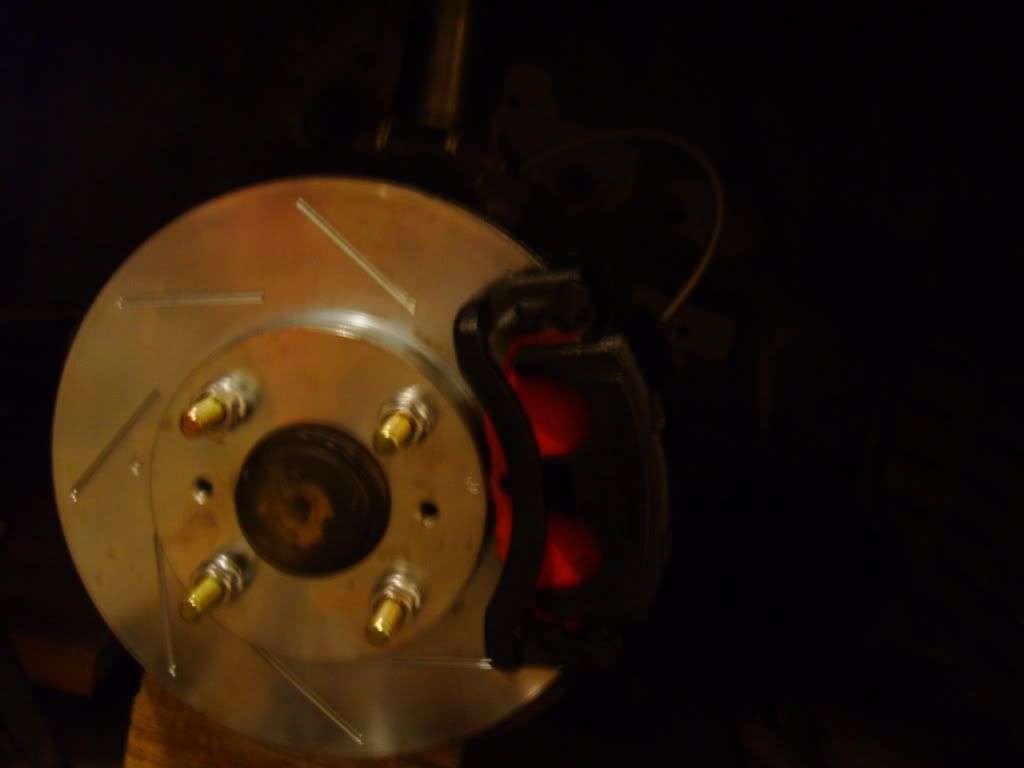

i did it.. i can show you pics. Im using asbestos for now. brb Oh and I have brembos slotte rotors and my caliper is blaack.

^Mines, peak performance extended studs, goodridge ss lines, stock rear w/ studs & ss lines. Oh and on a 97' S14

But mine fits perfect, and stops on a dime.

Yeah? Hmm I dunno but I do know that it fits nice and snug and it works!
