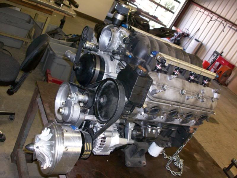

So some of you may have been wondering what I have been upto lately.
Well since the turbo kit we made is finished, and we can send them out to be produced I figured it was time to do something crazy.
Build a 1000 WHP Lsx Rx-7
Well here we go. this will be the first post of many to come.

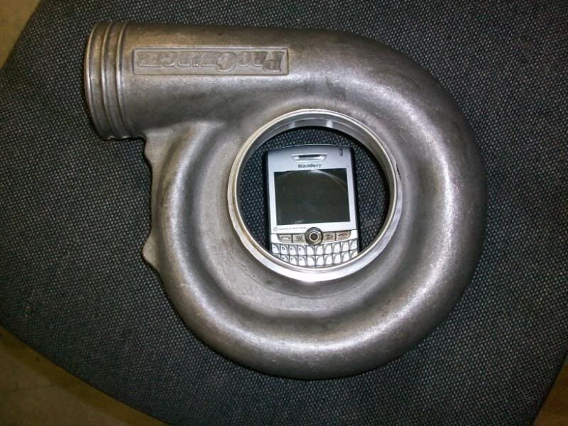

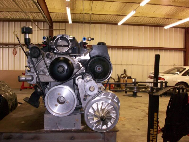

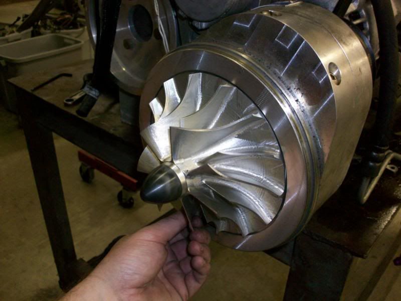

Procharger F1R rated to 1300 Hp
Holy compressor wheel!
6.0L LSX block.
Diamond Forged pistons 32cc dish, 4.030 bore
Manly Aluminum forged rods Stock stroke $$$
ACL race bearings
Arp Main Studs
Arp Rod Bolts
Ported Ls7 oil pump
Polished crank
Balanced to +-.5 grams at 8000 rpm
8 rib blower pulley conversion
ls7 lifters
comp cams cromoly pushrods
Arp Head studs
Cnc ported heads
Crane roller rockers
comp cams dual valve springs
comp cams titanium retainers
Stock valves
3 angle valve job
ls6 intake manifold
aeromotive fuel rails
rc 72 lb an hr injectors
and prob more that im forgetting.

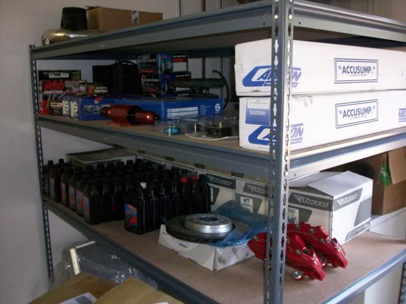

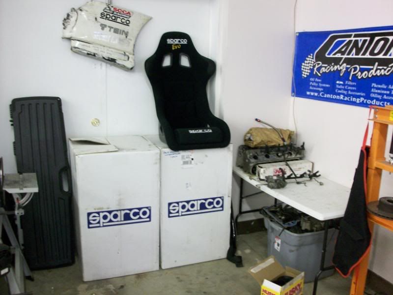

Sparco stuffs
Accusump stuff, Crazy fuel pump stuff, new brake kit stuff, sparco stuff, and oilz

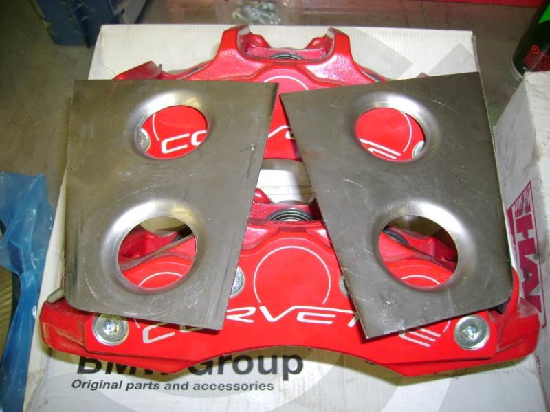

Dimple died gussets will be going everywhere.

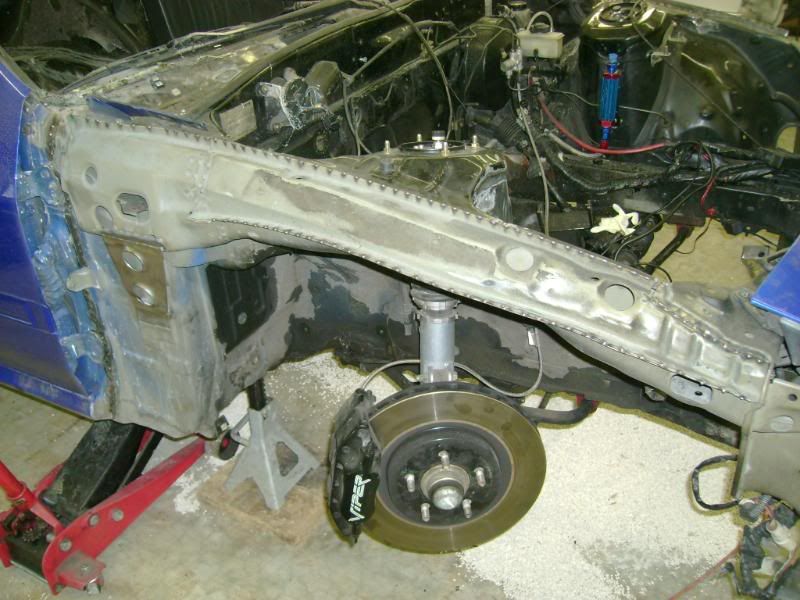

Beginning stages of seam welding and chassis prep.
Anyway. More to come. All this for an fc. And there will be a big surprise for everyone in a few weeks if everything goes our way.
