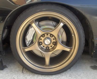

Anyone running the SPL Parts Big Brake rotor kit?
Its the adapter kit that allows usage of the 350Z Track edition 12.8 in. rotors
Just wondering what you guys thought about out if any of you has had first hand experience with it

I have it. It's nice cause it filled up my rims,but the caliper is to small for the rotor so it doesn't use all the rotor surface. Finding some acutal 350/G35 track calipers would be ideal and look perfect.here are some pics....

yea man, you lose about 2-3 millimeters of contact---> the brackets move the caliper too far out and not all of the pad is used.

You do lose a little bit of pad contact because the pad/caliper was designed for a disc with a different curvature. It does not affect performance because brake torque does not depend on area of pad contact, it just depends on rotor diameter, pad material and pressure. You will probably wear through pads slightly faster but at least Z32 pads are much cheaper than big brake kit pads

is there any way you can post a pic of the pad you currently use? i am very interested in seeing what portion is unused on the pad...

i feel very hesitant about the hang over... does anyone have a picture of this hang over? is it a super small amount? does it go across the top of the pad? is it a huge chunk?

its about the thickness of 2 or 3 rotors stacked on top of each other. but im wondering if you can defeat this by running evo or sti rotors(13inch) ?
