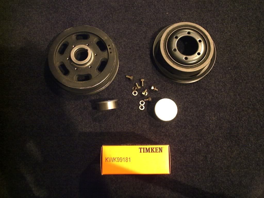

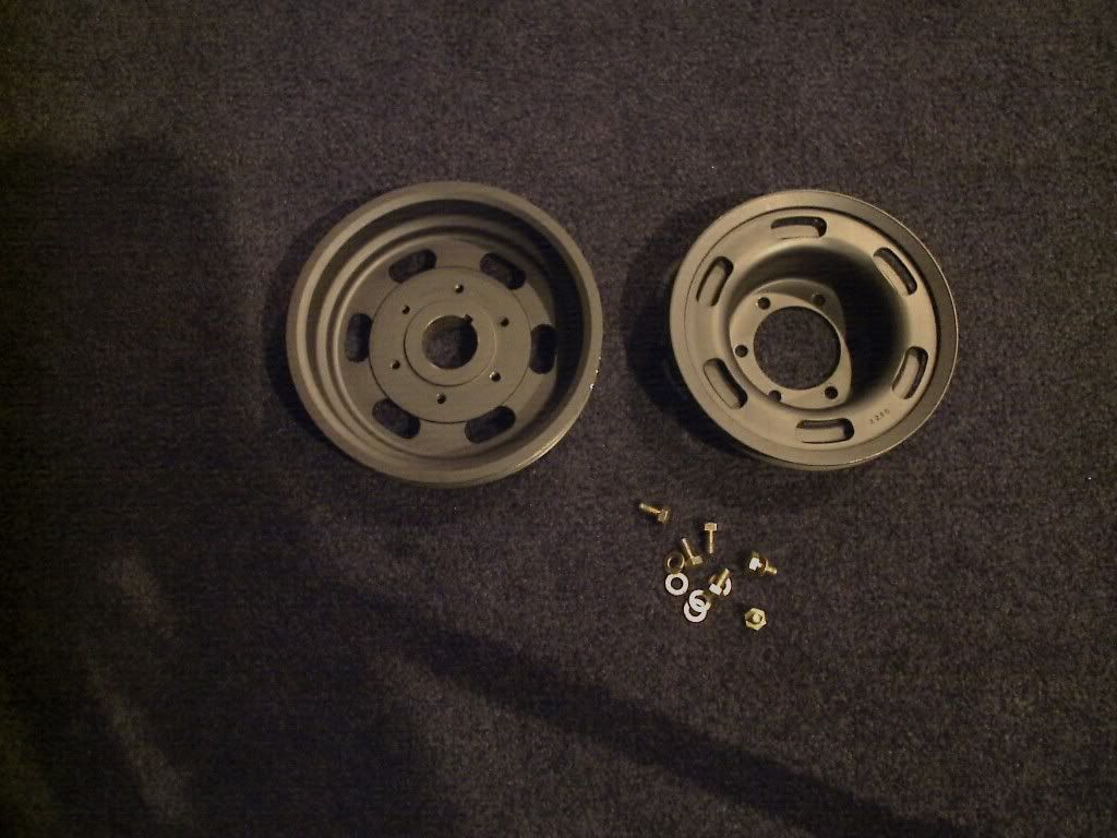

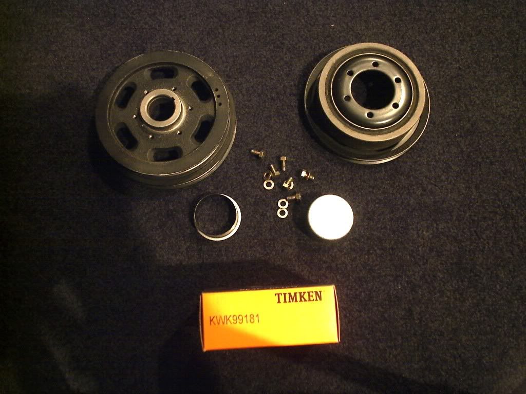

For those KA24DE that still get a leak after replaceing the front main seal this might be a fix for you.
I found a TIMKEN kwik repair sleeve for our KA24DE crank pullley, thought I'd share it with you guys, I have found 4 KA24DE crank pulleys to replace my crank pulley that has a wear groove inbeeded into the crank pulley only to find that the other used pulley have the same exact wear groove and still leak even with a new crank shaft seal, figure since all this pulleys are high milage and over a decade and a half old that i'd try this rather than spending $230 for a new one from NISSAN or buying a cheaper aftermarket one.
Heres the part number:
TIMKEN Part # KWK99181
Kwik Sleeve, Optional Repair; Front
The cheapest I found it was from this site:
$17.32
http://www.rockauto.com/dbphp/mak,NI...cc+L4+MFI+(A)+[KA24DE]
Additional info here:
http://www.timken.com/en-us/products...ersleeves.aspx
Here are some pics:
Sorry I didn't get finished pic's but it pressed on nice and snug.
