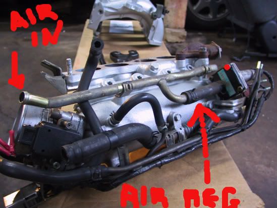

try disconnecting the engine coolant temp sensor. run the car without the air filter for a second to see if that helps. the air regulator is supposed to open and supply extra air when engine is cold. idle should be maybe 500 rpm higher when engine cold because of air regulator. squeeze the hose after it branches off to air regulaot. if it is open, squeezing should lower idle.
reinvent is offline   Reply With Quote
Old 01-03-2009, 07:27 PM   #5
reinvent
Location: illinois
Posts: 104
reinvent is an unknown quantity at this point
this is air regulator on dohc. the sohc has the iacv in a different place so
anyway, air is supplied via the brass tubing and goes to iacv and air regulator.
idle screw is on the iacv
http://zilvia.net/f/tech-talk/218807...ml#post2379043
