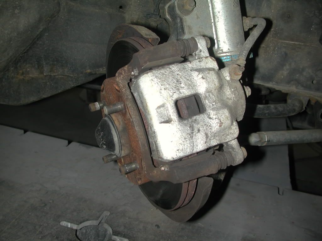

alright i got a 2 part question here. i am swapping my s13 from 4 lug to 5 lug and need new brakes. i have 180sx front brakes and im pretty sure stock s13 rear brakes (i need assurance)
now do i need 95 maxima rotors(for 5 lug) and 95 maxima pads for the fronts being i have 180sx front calipers.
for the rear i just need s13 brake pads and s13 rotors correct?
heres the pictures of my front and rear rotors / calipers. (can i re use the front rotors or do those look shot? they're project mu)

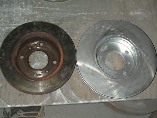

http://i4.photobucket.com/albums/y12...s/DSCN9428.jpg
Here is a side by side comparison of the old brake rotor vs the new one.
http://i4.photobucket.com/albums/y12...s/DSCN9434.jpg
This clearly shows the overhang as described, however it has not presented any reliability issues.

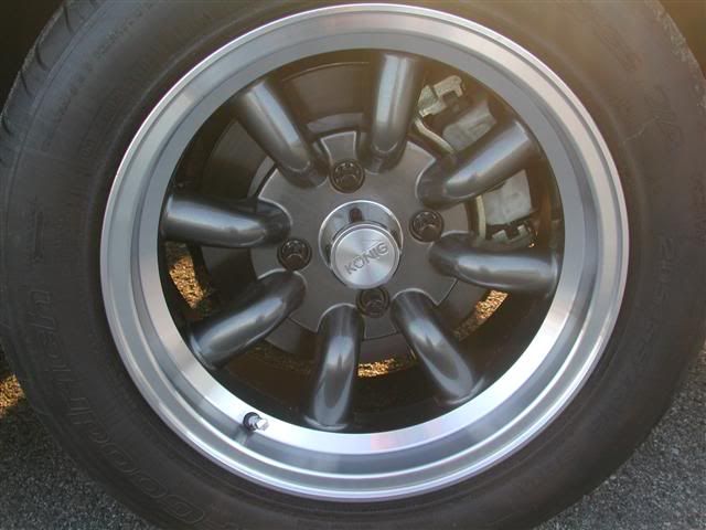

http://i4.photobucket.com/albums/y12...z/DSCN9596.jpg
Heres how they look behind a 15 inch wheel. Sexy brakes...
