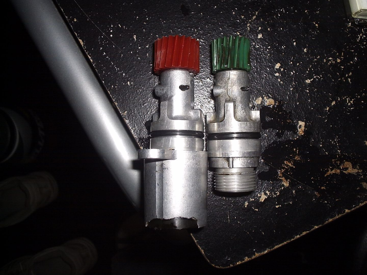

Ok guys need some help here, hopefully someone has a Z31 M/T speed sensor and could compare the bore diameter to that of the S13 M/T speed sensor.
Now your probably wondering what im trying to do, will I have a 97-01 Q45 VLSD with a 3.692 final drive which im going to install into my S13 but I want my speedo to be accurate or atleast close as possible, so after doing a little searching on Nissan FAST I was able to see that the Z31 NA M/T and S13 M/T both use the FS5W71C transmission's duh.
I also know that the Z31 comes with a 3.700 final drive which is close enough for me (3.692), so i wanan get my hands on a Z31 speed sensor from a 3.700 final drive equiped FS5W71C Z31 and see if the speed sensor fits which I think it should since there both the same trannys and I have no reason to believe the casting of the rear section shoudl be different.

I'd bet it will fit fine, same rear case, it'd almost have to. As far as who has one, shit. I haven't seen a Z31 in a salvage yard in years.

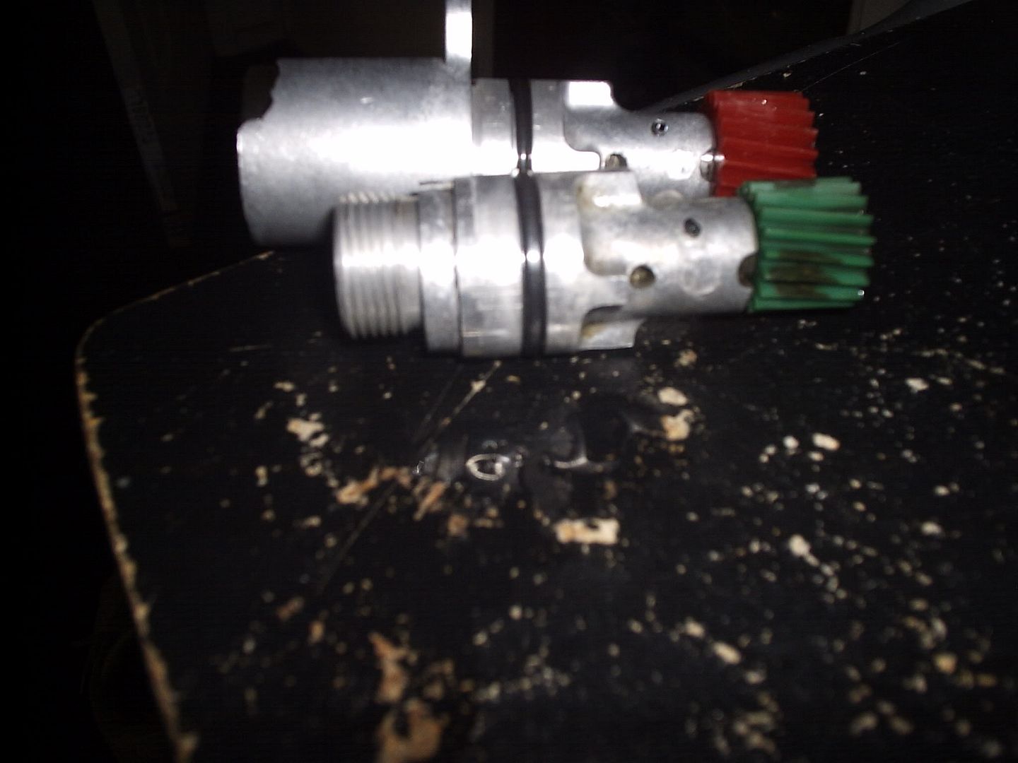

Will I learned today the Z31 VSS does fit but its mechanical so I guess imma try Courtesy Nissan Texas to see if they have the NISMO 17t pinion available, its shows that it is for S13 but for S14 mostly all pinions are NLA.
Also the Z31 pinion is not removable, I tryed its totally different than that of the S13 pinion.

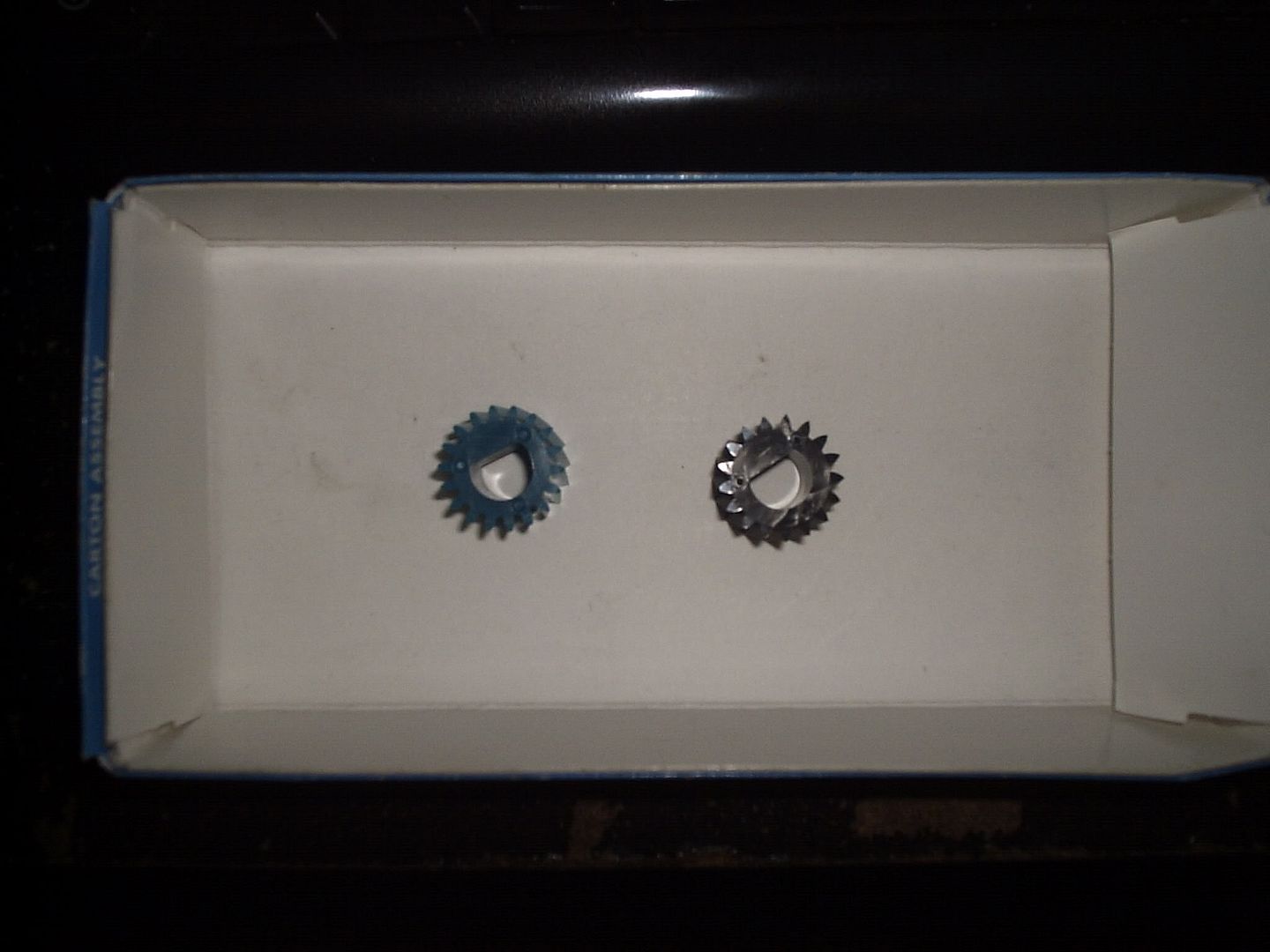

Called Courtesy Nissan Texas and they said the S13 M/T speedo pinions are available at $25.00 each so I think imma end up buying both 17t and 18t pinions....

Ok I just ordered a S13 M/T 17t and 18t speedo pinion from courtesy for ~$60 shipped because I dont know which one is gonna be best suited for the 3.69 final drive so I bought both, hopefully this is accurate enough to avoid the other options which seem like alot of work....

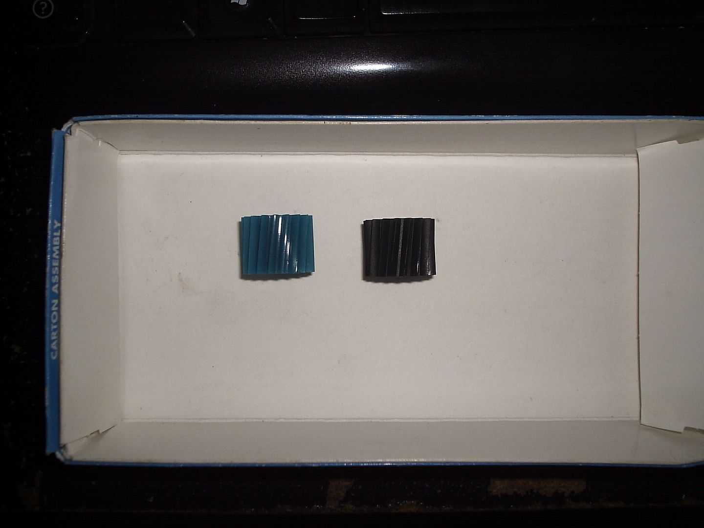

Well I got the speedo pinions today, I haven;t installed the 3.69 VLSD yet but when I do i'll let you guys know the results.
Pics:
17t = black
18t = blue

Also liek to add to this thread that the 18t speedo pinion gear and the 3.69 FD are a perfect match as long as yoru running a comparable to stock rolling diamater tire size.
The speedo does require re-clocking so that it meshes with the speedo pinion drive gear in the transmission though.
If you look at the speedo its bolted down at the 6:00 O'clock, this needs to be reclocked to atleast 9:00 or 3:00 O'clock (which ever direction you want doesn;t matter) so that contact is made and everything works out like a charm.
