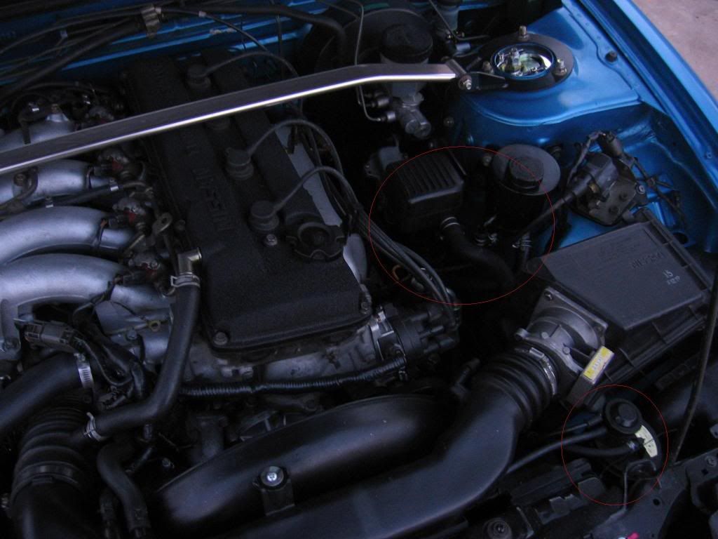

They want to see the EGR system & Charcoal Canister.
The pump ive circled also vents to the stock intake. They want to see that hooked up for sure. If you dont have the stock intake box/pipe, the run a hose to a bung on your intake.
The other is the charcoal canister.

That box is called the PAIR valve.

how can your name be handinpants if your not wearing any? anyway smog devices would be egr, AIV, charcoal canister, and your catalytic converter. you need all those parts to pass smog and you cant "add more"
and that box is for air injection, also known as AIV (Air Injection Valve)
