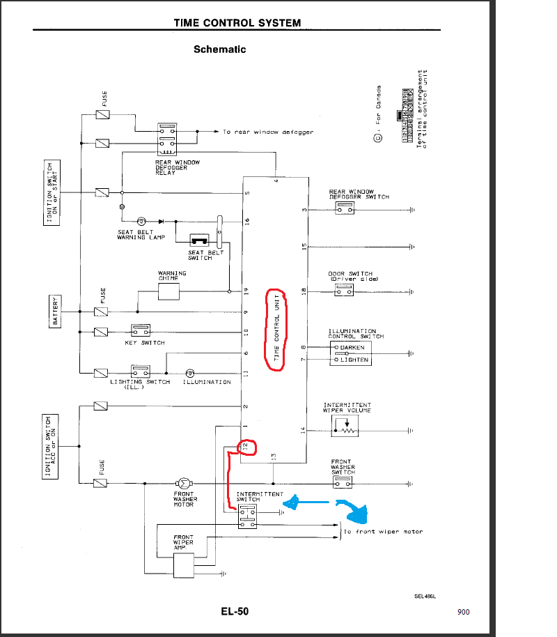

according to the 91-94 wiring FSM diagram, the TCU (time control unit) "that little white chime box" has the circuit tied into the wipers circuit. check that.
heres a picture to show the diagram..
