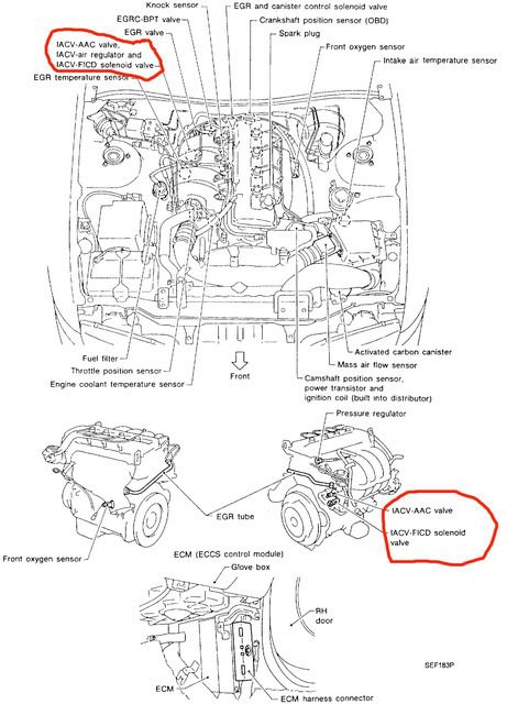

Idle air control valve ?
That thing on the back of the engine?
fatlizzard is offline   Reply With Quote
Old 06-16-2009, 07:09 PM   #12
j450n_760
j450n_760's Avatar
Join Date: Jun 2009
Posts: 3
j450n_760 is an unknown quantity at this point
its in the picture on the top left and bottom right
