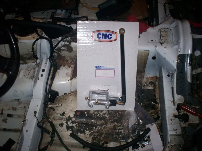

You mean something like this? Im using a cncbrakes.com hydro staging brake for my ebrake. I believe there is a write up on this particular one on here some where so all your question can be answered! if not pm me and ill answer them!

Here is my CNC brakes, brake.
