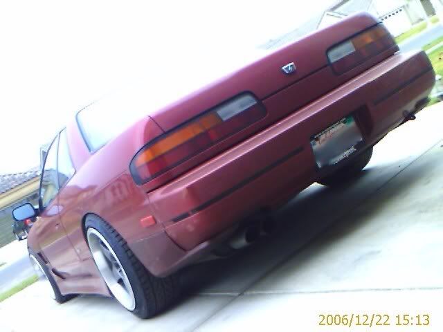

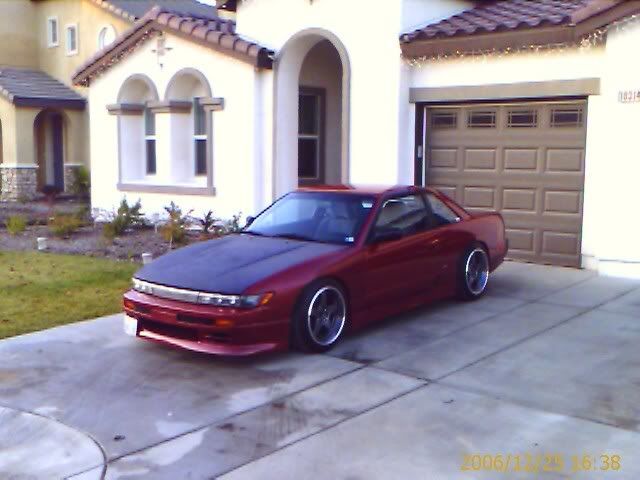

I've been running 962s on my S13 for a long time now with this setup:
Front: 15mm spacer w/a 5mm spacer sandwiched (between the spacer and hub) and a 3mm spacer on top
Offset = +12
Tire size: 215/45/17 or 225/45/17 Federal 595RS
Rear: 15mm spacer w/a 5mm spacer sandwiched
Offset = +15
Tire size: 225/45/17 Federal 595RS
Here's a pic:
Attachment 14335
This is a "reverse" stagger where instead of the rears sticking out more than the fronts, it's the total opposite! I know it probably goes against the grain in terms of "preferred" wheel aesthetics but it's hardly noticeable unless you look really close or are really picky.
I haven't had any problems (i.e. vibration, wheel shimmy, etc.) running this wheel setup- I just check to make sure the spacers are torqued down to correct specs before and after doing a drifting event or after driving a lot of miles.
Hope that helps.

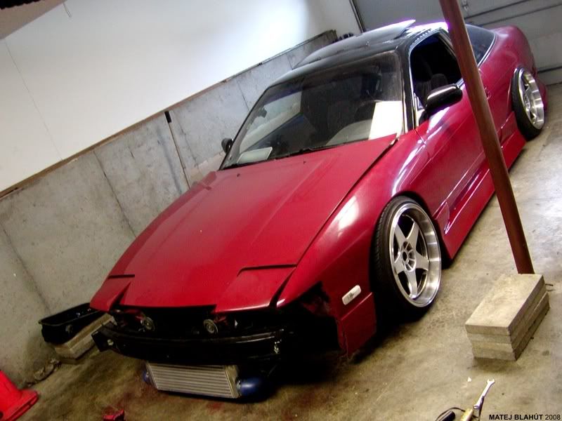

ask matej.
the only person to ever make sportmaxes look good.
old pic of his car.

True. Matej's car was sick with those, it's still sick. I think so at least.
Sick. I just saw some old pics of his car with meshies while I was looking for that one. Weird.

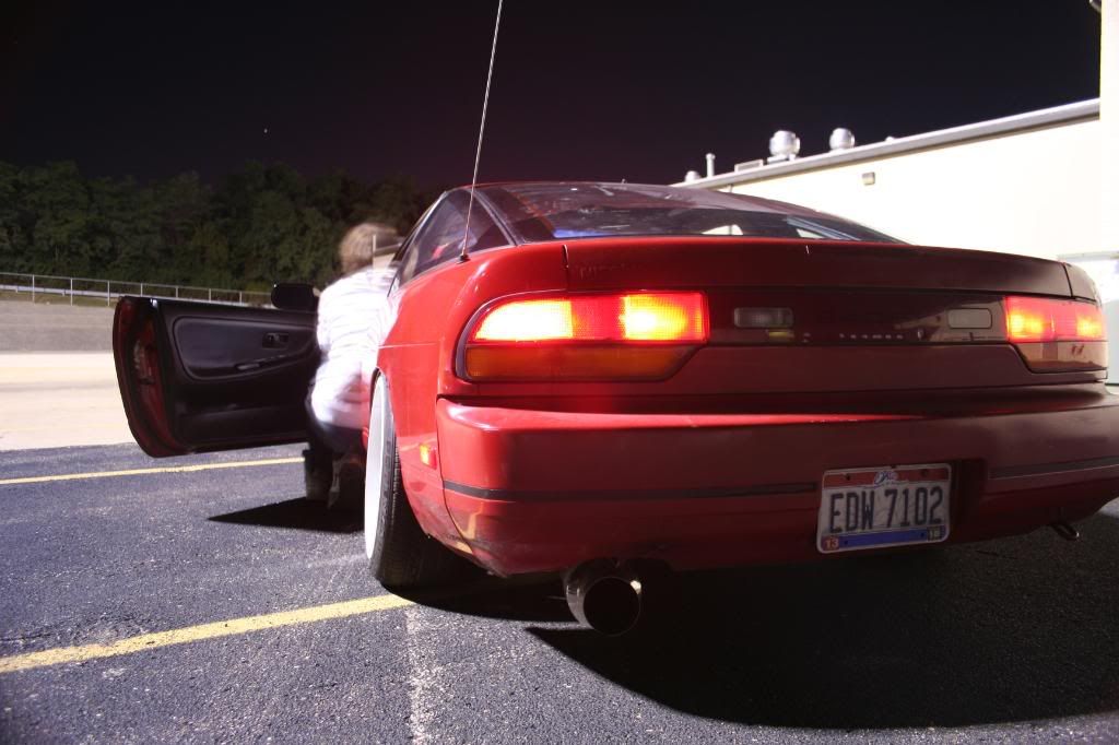

i had 17x9 +35 on my s13 before
i went with 225/45 for the tires along with 25mm spacers all around.
rolled rear fenders, 20mm fender on the front
this should give you an idea
