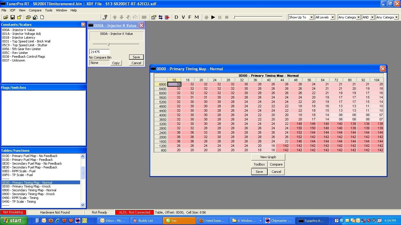

it looks like some values may have been changed in the "primary timing map" table. Here in the lower right hand corner.
Is this normal?

those are stock values, dump your rom and compare. the only thing modified on that rom is speed. To show hex values, right click the gray or tan area, select show hex
