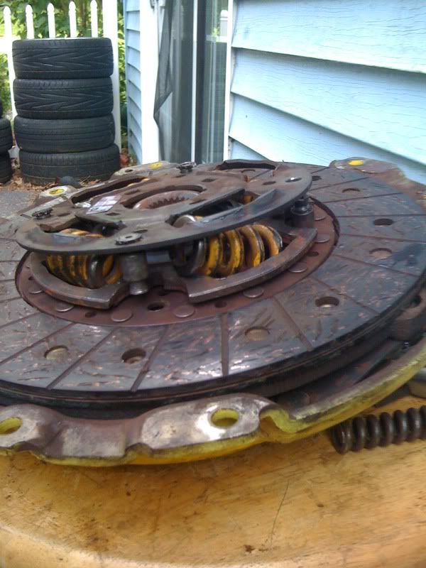

sounds like the same problem im going threw right now. i took my trans out and found this
act street/strip disc with less than 10k on it
