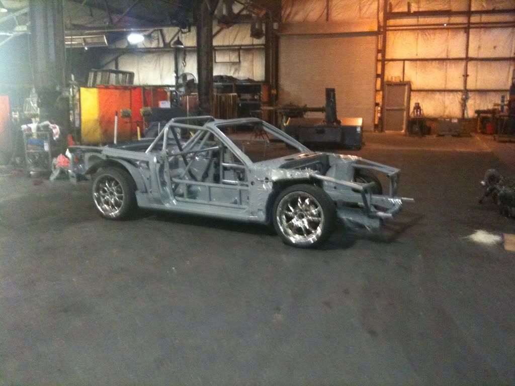

Pull it out, make sure frame is straight, makes sure that the welds
at the door are still intact too. Then if toucan do steel tube front from the strut Towers
Like this for example, how the guy at my shop fixed his

yea thats how the guy i know is gunna do mine with the tubing..he is also gunna do a rad support so i can push the rad a little forward to run fans behind the radiator..i think ill try the ratchet trick and if that doesnt work then ill get the tubing
