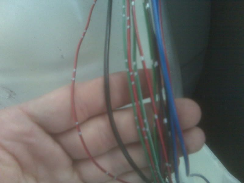

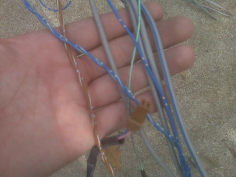

Here are some pics:
Wires that REMAIN IN THE CAR, going to tail lights/trunk light etc...
Wires that got cut out:
THEY ARE ALL THE SAME WIRES, just two different pictures.
