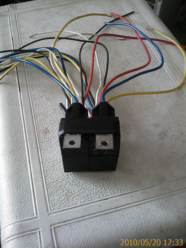

The first thing we want to do is setup our relays. Put 6 in a block type setup and tape them together well. This is a picture of 4 relays taped together, you'll want to do the same thing, but with 6.
Once taped together, attach the harnesses to them. You can make your own harness but I would suggest buying pre-made harnesses for these relays. You can find them on ebay or other websites.

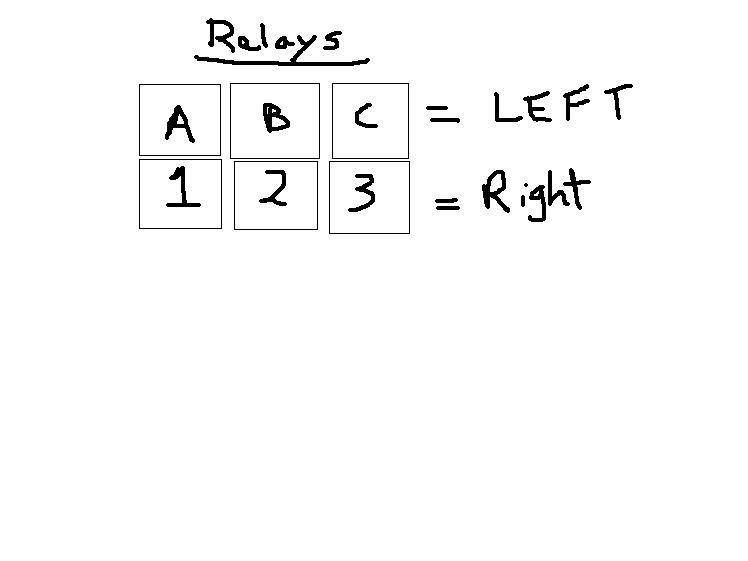

Now you should have 2 rows of 3 relays taped together, the top 3 we will designate for the left hand side, and the bottom three will be for the right hand side. Now you will need to figure out where your relays will be placed within your car so you can calculate the amount of wire you will need. I bolted mine to the chassis directly underneath the wiper motor.

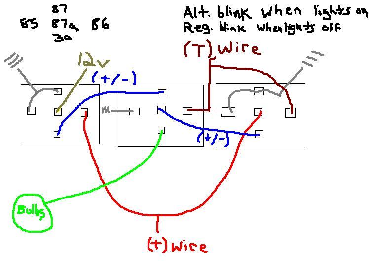

Relay [A] Connections
Relay[A][87a] -> 10A Fuse -> Battery.
Relay[A][87]
-> Chassis Ground
Relay[A][85]
Relay[A][86] -> (t) Wire from LEFT turn signal
Relay[A][30] -> Relay[b][87]
Relay [b] Connections
Relay[b][87] -> Relay[A][30]
Relay[b][87a] -> Relay[C][30]
Relay[b][85] -> Chassis Ground
Relay[b][86] -> (T) Wire from LEFT turn signal
Relay[b][30] -> To Bulbs
Relay [C] Connections
Relay[C][87]
-> Chassis Ground
Relay[C][85]
Relay[C][87a] -> (t) Wire from LEFT side marker
Relay[C][86] -> (T) Wire from LEFT turn signal
Relay[C][30] -> Relay[b][87a]
You apply the same connections to Relays [1], [2], [3] but the only difference is you connect the RIGHT turn signal wires instead.
(t) Wire is the red wire from your side marker on the engine harness side once you cut it.
(T) Wire is the toggle green wire from your turn signal that pulses on and off.

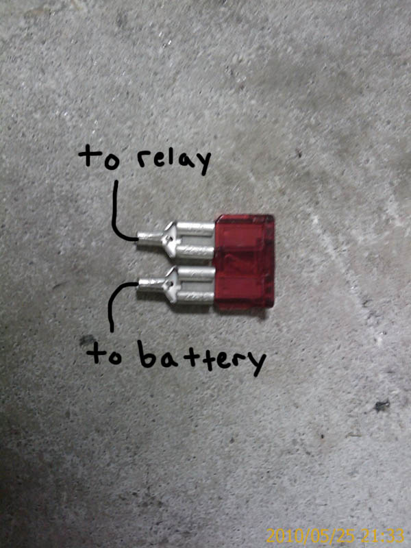

The first connection we are going to make involves Relay [A] and Relay [1]. Take the [87a] wire from both relays and a 12Gauge wire that is long enough to reach the battery area (or any other reliable 12V source). Twist all three of these wires together and then solder them accordingly. After soldering, tape them up nicely. After every solder its very important to remember to tape it up good (so that there is no chance of the tape unraveling). So as of right now you should have 2 wires from both Relays combining into one wire that is long enough to reach the battery from your relay mounting point.

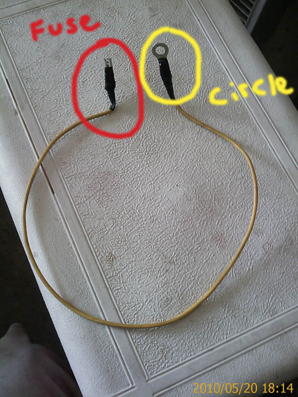

The next step is the crimp a little fuse connector at the end of this wire, later on we will be connecting this to a 10A fuse. The picture below is just to show the type of connectors I'm talking about. Not the step you've just completed.

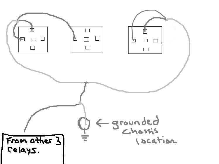

Ok, now that we've got our constant 12V source situated, it's time to establish our grounds. There are 5 ground wires per set of 3 Relays, so 10 ground wires total. What I did was, combine three ground wires into one 12Gauge wire, then the other two ground wires into one 12Gauge wire, then joined those two wires into one wire.
You can do it however you want, but its imperative that all these wires are grounded otherwise your relays won't function at all.

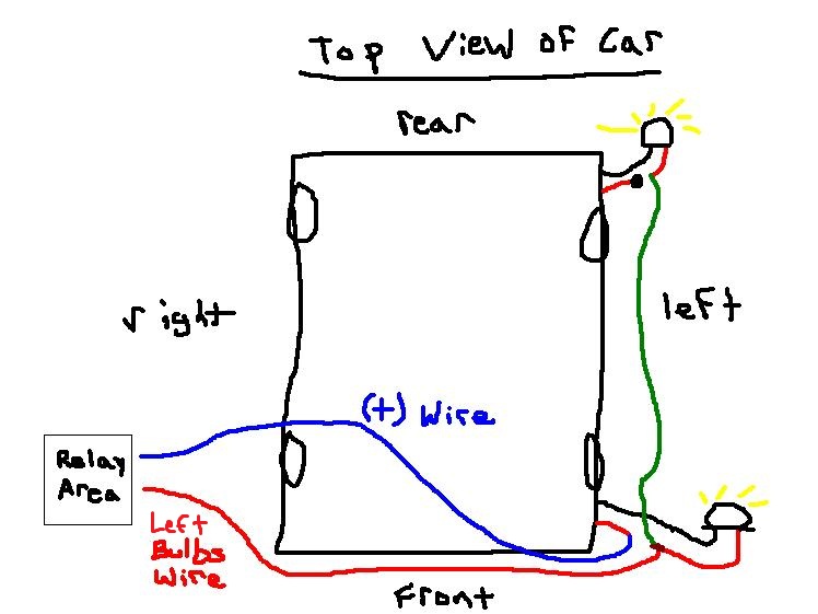

The next part of this write-up will focus on preparing your car for this new setup. So put the relays down for a while and lets focus on the car...
Pull out the side marker on the LEFT side and look at the harness. You should see a red wire and a black wire. We need to cut the red wire so that there is enough slack to work with on both ends. So cut the red wire now. Now, the wire that goes back into the engine harness needs to be extended to the relay area. So solder in a new 18Gauge wire and route it all the way to your relay area. This will now be called the (t) Wire. Go to the right side and do the same thing. Now you should have two new wires in your relay area, (t) Wire LEFT, and (t) Wire RIGHT. Don't worry about the other cut end of the red wire right now, we will get back to that in the few steps.
Now the annoying part of the installation, We have to route a wire from the rear to the front to accept the cool new blinking action. Go the back of your car and locate the side marker harness and pull it out like you did for the fronts. Now again you'll see a red wire and a black wire. Cut the red wire. But this time, the side that goes into the body harness will need to be taped up, we won't be using this anymore. And the wire that goes into the bulb needs a new 18Gauge wire spliced into it, and long enough to reach the location of your FRONT side marker. From there you will join the two wires together into one 18Gauge wire that will route to your relay area... label this wire "LEFT BULBS".
Sweet, now do the other side! Then label that wire "RIGHT BULBS" This will take a bit of time if you want to conceal the wires perfectly. Because you'll have to remove the floor piece and run the wire to the back behind the interior panels. If you've installed your own alarm system you might familiarize this step with wiring your trunk light to the alarm.

Bring your relay block to your car and mount it appropriately. The first connection we will be doing is the ground wire. Find a spot on your car with a clean contact of bare metal and cut a 12Gauge wire that is long enough to reach the relay area. Crimp down a circle connector on one side of the wire nice and tight, and bolt it to the car. Then bring the wire to the relay area. Now take your ground wires from your relays, and combine them with the ground wire you just bolted to the chassis. Solder it up well and then wrap it up nice with tape.
So lets move onto our 12V power source. You'll need to cut a 12Gauge wire about 2 feet long. At one end of this wire you will crimp down another fuse connector. At the other end you will crimp down a circle connector. It'll look just like this...
The circle connector end will bolt up to your battery. The fuse connector end will connect to the fuse. Remember at the beginning of the write-up I had you crimp down a fuse connector at the end of the wire coming from the relays? Now we need to join them together with a 10A fuse...
