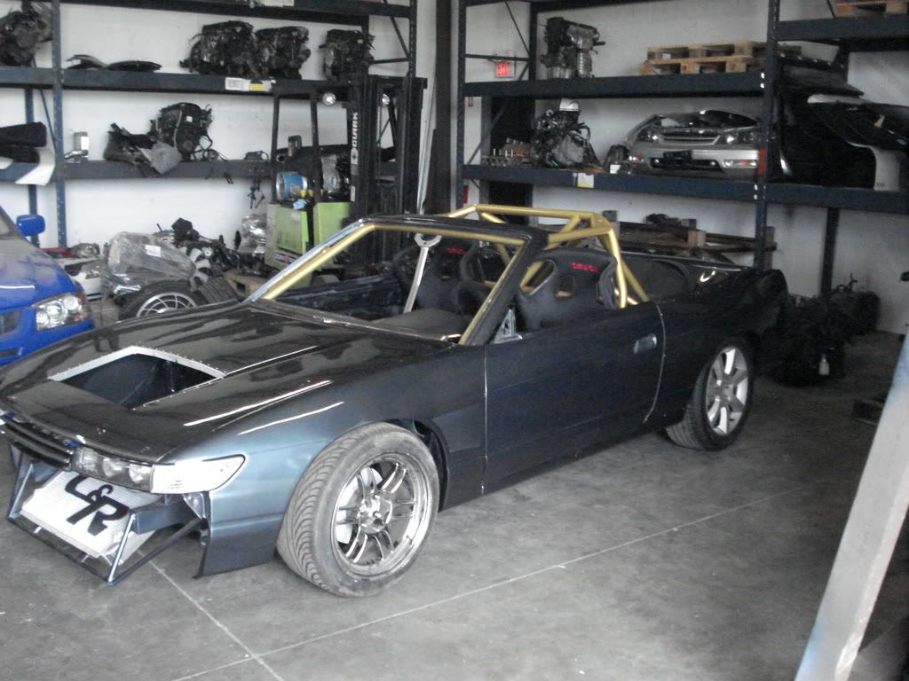

Chassis :
1994 S13 Vert
Fully Stripped
Media Blasted Remove All Paint, Seam Sealer, etc ...
Cut all Vert Top Mounts, Motors, Linkage Out of the Way
Extend Front Frame rails
Build Supports and Framework for V Mount

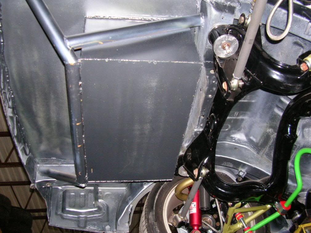

Box in rear seat compartment and vert linkage area
Box in Spare Tire / Floor, Build Box for Fuel Cell
Roll Cage Fabricated
Underbody Cage for Fuel Cell
Stitch Welded
Front End Tubbed
Cage & Car Was Painted
Stainless Hard Brake Lines were Fabricated using AN Fittings

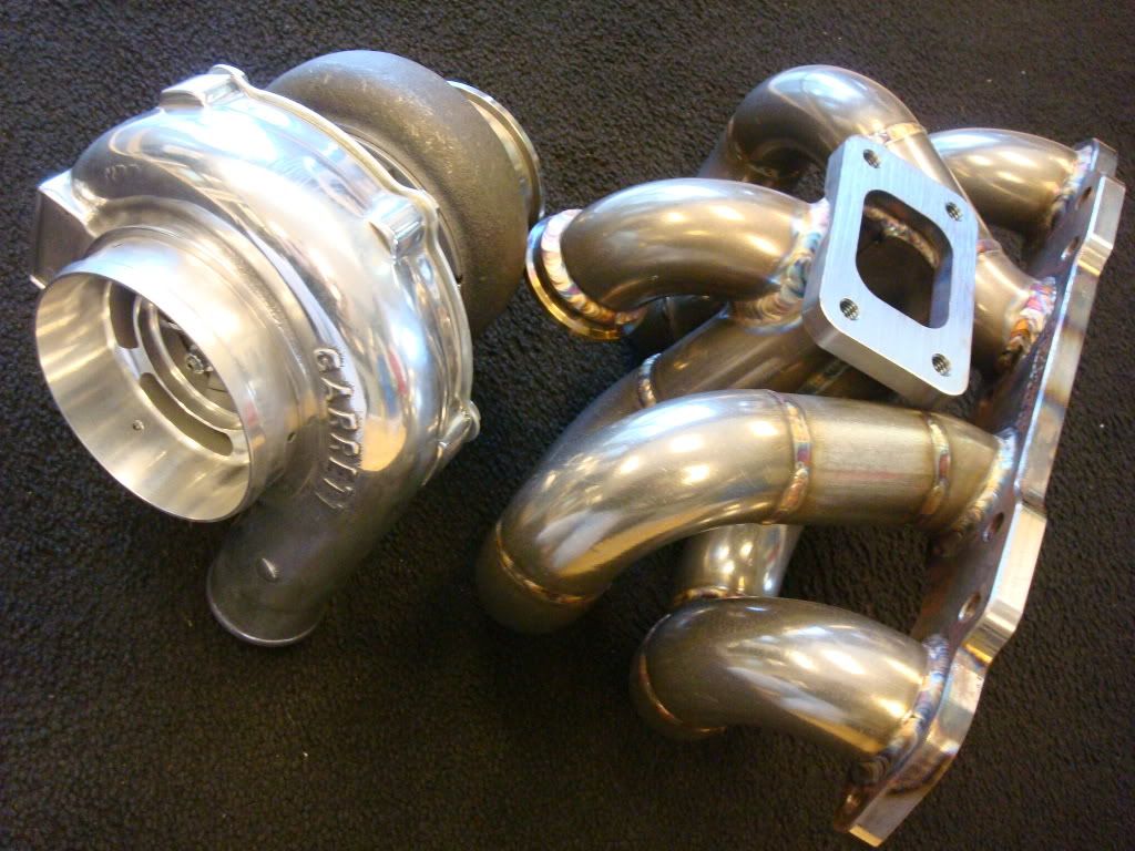

Peak Boost Top Mount Manifold
GT3076R Turbo Polished & V Band
44mm Tial Wastegate

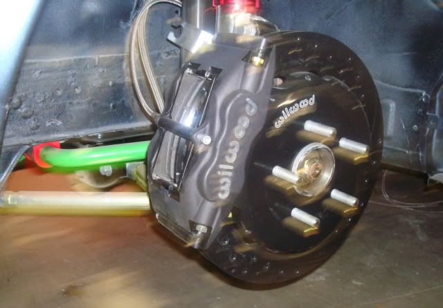

Wilwood 13" Big Brake Kit
Wilwood Brake Lines
