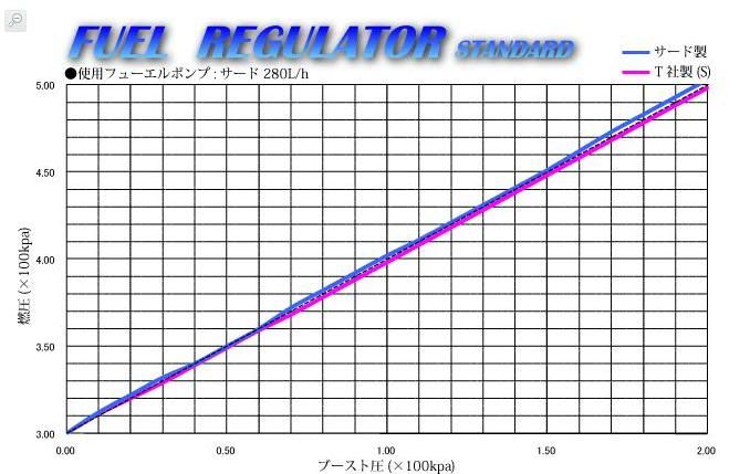

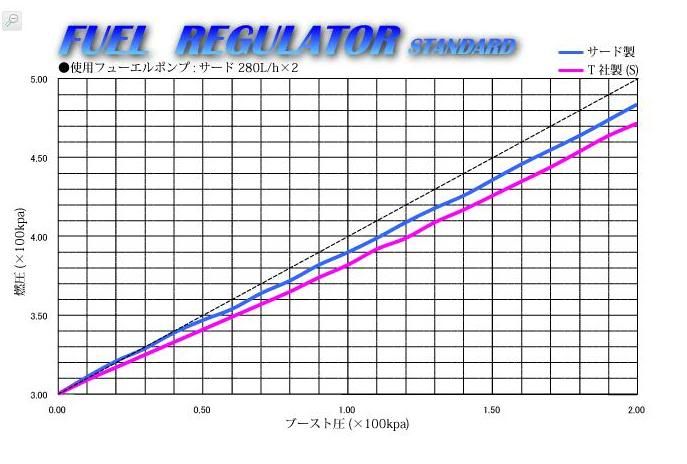

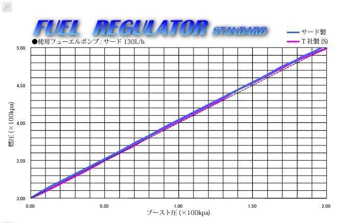

Can anyone translate Japanese or pull any info from these graphs? What exactly is going on here?
