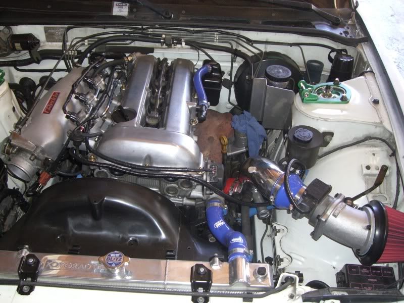

Here is a picture of my build in progress. Just for fun.

^same here, but where did you get that intake from? if anything get a catch can and plug up that hose on the intake and get a aftermarket exhoust mani then get a power fc

The Intake is an Apexi suction kit. I also used the Apexi MAF adapter and i have a custom coupler that goes from the Suction pipe to the MAF. This engine is not running yet and i am going to be getting a catch can. That plug i have there is just so nothing gets in there while the engine is sitting.
