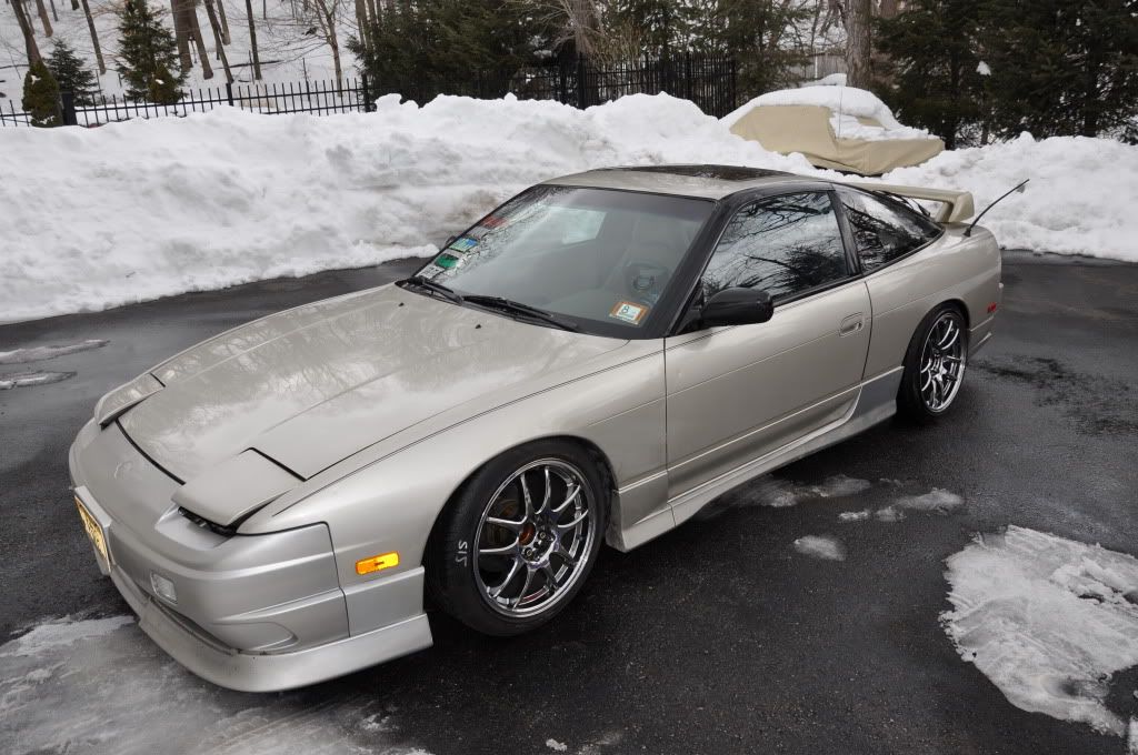

Hey hows it going guys? I just bought a set of (4) XXR 512 Rims which are 17x8 and have a +15 offset all around. My question is would 225 45 17 be fine with this size? I have coilovers and I'm not slammed. I don't want to have to pull or roll fenders. Anyone who has pictures for reference would be perfect, thanks in advance! The rims will be going on this car:
(in this pic theyre 18x9.5's +30 offset all around in 255 35 18's)

It'll be sunk. 17X9+12 or so is perfect. Fender roll is easier than a diaper change.

17x8-5 is flush fitment. with a 215/40 tire.

Thanks for the comments guys. So youre saying its sunk but not horribly sunk like +40 offset right? Lol this is just my winter setup so im not too anal with flushness. What tire size would you guys recommend?

Nothing will be flush without rolling fenders.
