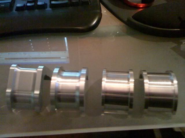

Solid steering rack bushings.
Here is something i have been working on. should be available soon
Going through test fitting now

seems like a "solid" idea.
what do you think the pro's and con's will be?

No pricing has been determined yet i have to figure out how long it takes to me the full set

It will be cheaper then the "other Brand"

I posted this in the other thread too, but you should make some that offset the steering rack as far forward as possible, as this helps eliminate some of the overcentering that occurs when using modified knuckles.

Pricing should be around $80 for the set.

Here is one thing that I can't stress enough with about 6k miles on my yanack solid bushings....
If possible put or supply a layer of tacky rubber or some nice rubber to fill gaps that happen to be there. This will help reduce rack shifting under lateral pressure from turning the tires and outside pressure from tires gripping the road. No matter how tight you get it or how in spec, not all racks are the exact mold, so if you can supply some rubber inserts to help fill any gaps, I think it would make this way better than Yanacks....
I filled in my gaps with 1/8' - 1/16' rubber from silicon hoses as they can grip on metal or aluminum really well...
Just my opinion.

I already planned on that and picked up the material for it
