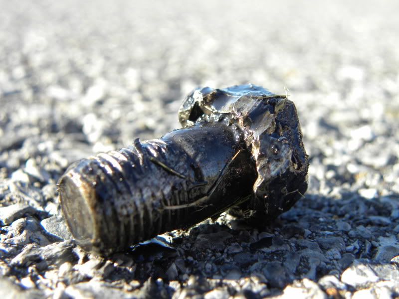

I had something similar happen. When I pulled the diff this is what I found.
Those go on the outside of the diff bro, lol
How did you weld it too?
When I did mine 5 years ago, I just had the 8 points welded.
It's a bolt that holds the ring-gear to the diff.

s13coupedrfter has a reputation beyond reputes13coupedrfter has a reputation beyond reputes13coupedrfter has a reputation beyond reputes13coupedrfter has a reputation beyond reputes13coupedrfter has a reputation beyond reputes13coupedrfter has a reputation beyond reputes13coupedrfter has a reputation beyond reputes13coupedrfter has a reputation beyond reputes13coupedrfter has a reputation beyond reputes13coupedrfter has a reputation beyond reputes13coupedrfter has a reputation beyond repute
I bought a car with a welded and this same thing happened to me...the ring gear bolts came loose and punched a hole in the aluminum diff cover.
I will never trust a diff that someone else welds/installs. Ive done this mod many times over and I always use red locktight on the ring gear bolts and torque to FSM specs. Never had a problem.
