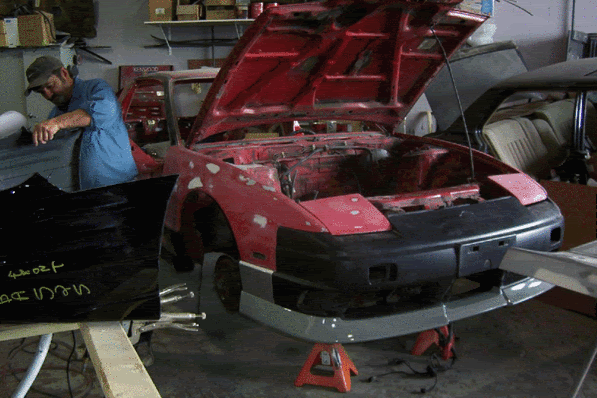

If you are going to do a color change, bite the bullet and cough up the cash for the body shop to do a proper job. I paid a fortune for my paint to go from the factory red to the factory Super Black. I took out all the windows before paint and the engine was removed for the bay to be scuffed and sprayed. Moldings were taken off and door jams sprayed too. If done right you won't be able to tell the difference that the car had gone through a full color change.
Before:
In process:
Final:

while removing the glass is an excellent suggestion, my friend
the problem lies in the fact that you still have the original color bonded to your vehicle. those spots of filler further prove that the body shop did not remove material, but basically filled and covered your car. therefore, any rock chip or delamination of black paint will result in the show of original color
color changes.. just not an easy thing to accomplish, properly.
i assume you kept your interior? pull up the carpet and you can see the red, yes? i used to love doing that to brunettes who died their hair black. the carpet just never matched the drapes hommie

oh yes won't deny that the color change was anything other than a "scuff-and-paint" type job. It would have cost me around $4-5k if not more to have them sand blast the car to take it down to bare metal. The inside of my car was sprayed, which in reality didn't serve much of a purpose since carpet and panels did go over it. The shop used quite a few coats of paint, and haven't seen the original color come through due to stone chips and things of that sort. Mind you I don't drive her much.
