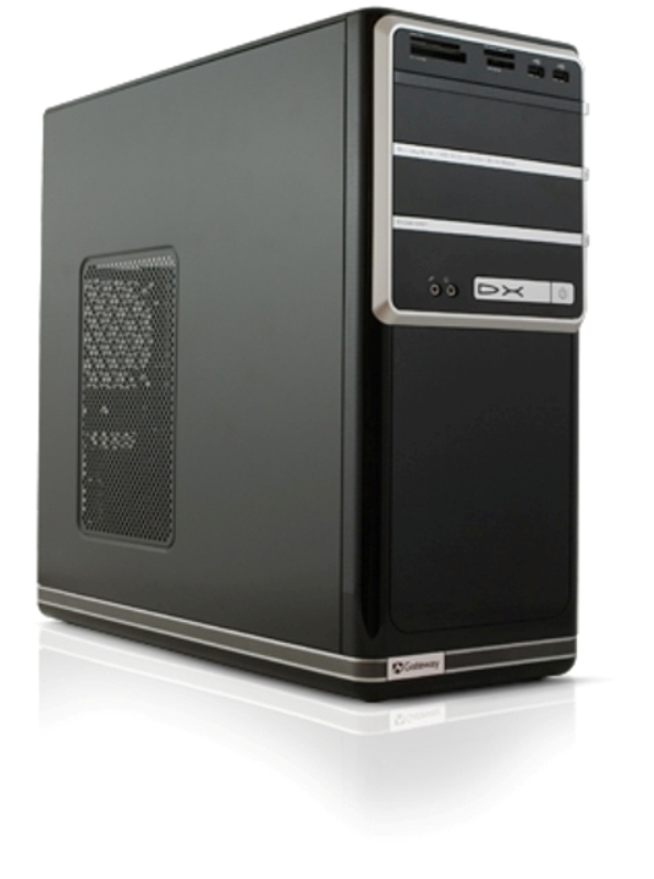

Recently my friend's dad gave me his some gateway desktop because he simply didn't want to deal with fixing it (motherboard). It's a Gateway DX4640-UB201A (Mediocre Desktop).
It's not horrible to look at so I'm not looking for a new case lol.
